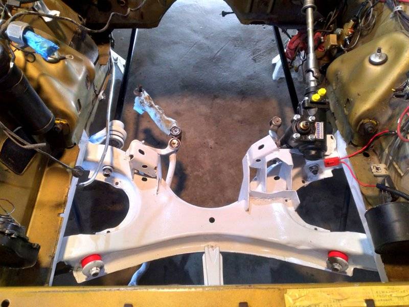

Definitely go with the Borg Box.

My fist replacement of the original steering box on my '69 Coronet was a Steer & Gear stage 2 box, which was good but still had that center slop like the old one had.
Not long ago i slapped in the Borgeson box and that made a night and day difference.
No slop, direct acting steering and when driving 60mph you do not need to continually correct for the slop, just bang on straight.
Like others already said, this is as close as you can get to a steering rack feel.
It's a costly upgrade, specially for me and others here in Europe due to shipping and import charges, but once i had my first test drive i already forgot about that.
