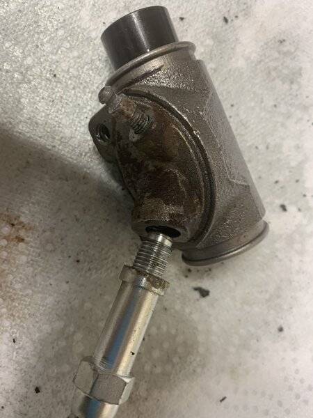

I have a question I hope somebody can help me if you look at the picture attached to this is there a brass washer that goes between the brake cylinder and a hose thanks Tom
Copper. Brass is too hard. Get a selection at the parts store.

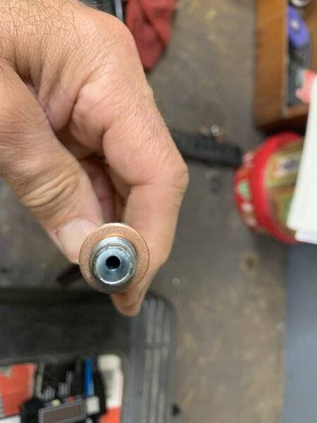

I just pick these up at autozone they fit perfect will give it a try has to be better than not having nothing at all lol thanks for the information Tom
