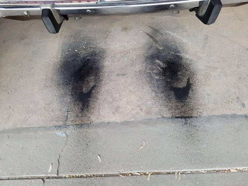

Check the power valve in the front metering block, maybe it ruptured. Something is making you pig rich.
The pig rich comment was based off the pavement. Whatever he's got going now isn't as bad
