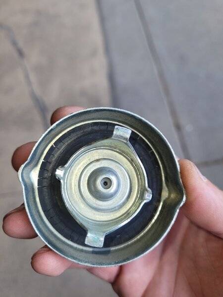

Is there a vacuum in the fuel tank?
Is the fuel tank vented, and is there flow through the vent lines in the trunk etc?
Is the fuel cap a vented or non-vented type?
Is there a return line to the tank?
There is a simple solution for this issue, but it will require a bit more diagnosis. Everyone is quick to blame a bad carb, but sometimes the answer is easier than that.
(No disrespect meant to any of the members who have suggested carb problems intended.) :thumbsup:
Not 100% if the tank is vented or has vacuum. Only a few years old, direct replacement from Vans Auto as well as a new neck and sending unit. I believe the cap is vented, that was a replacement from Rock Auto. For sure no return line to the tank. I know when it was replaced, he cut the 3 or 4 lines that were in the front of it and also removed the vapor canister in the engine bay and said it was no longer needed. Car ran without for the last 4 years and no issues, other than running rich and dieseling.

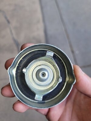

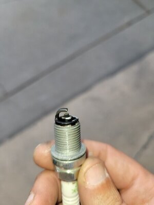

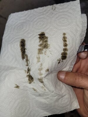

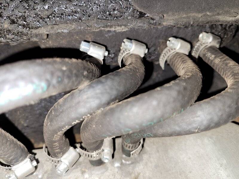

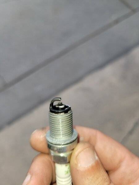

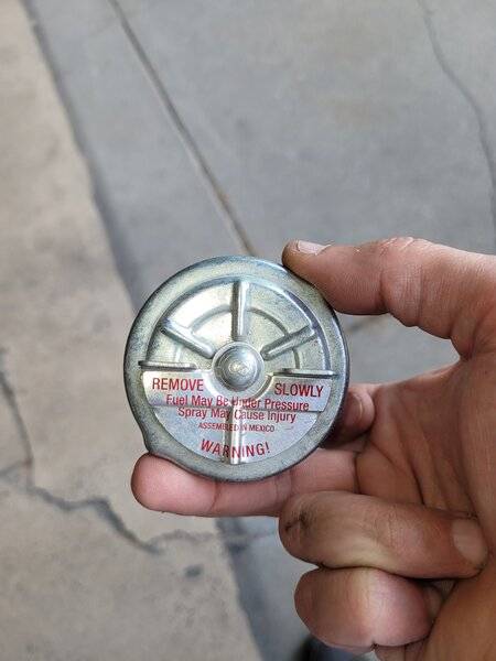

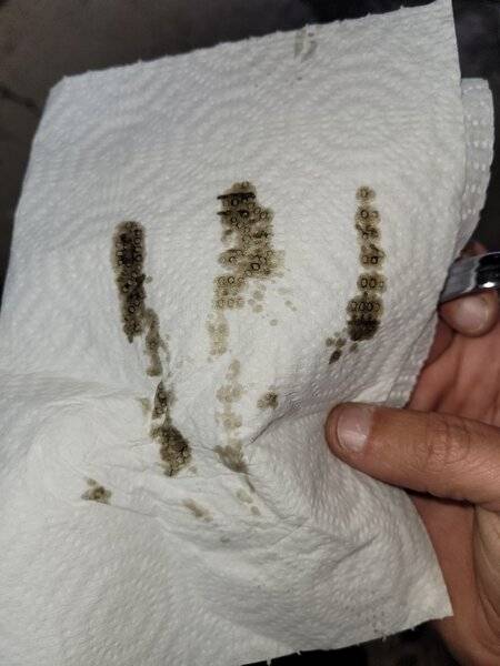

Fuel tank is vented through the trunk, at least i think. Theres lines from the tank going to the trunk floor, which i thought were cut. Also attached pictures of the gas cap. And a picture of plug #2. All of the plugs looked about the same. Oil from the dipstick smelled a little bit like gas, and i think may be a little thin. Oil level was a little low, maybe half a quart.
