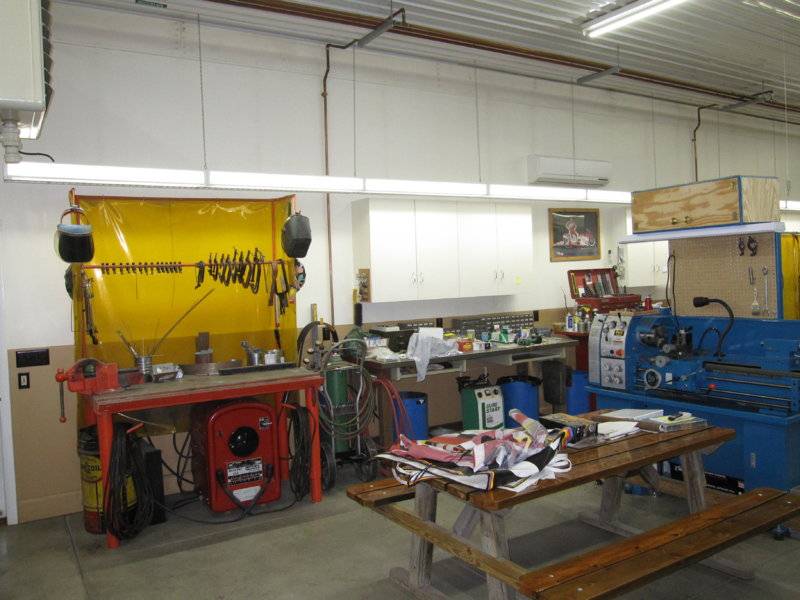

I have a mini split system in my garage in MI. I put it in solely to control humidity and it does the job. I am using a 12,000 BTU unit but, it can handle the task. Now, my shop is 36' x 68' x 12' and very well insulated so that is a consideration. Even without the A/C on the shop rarely gets over 75*. The indoor unit/evaporator is above the lights over my tool box.

My garage is 28 x 40 and a 36k BTU cools it just fine in the SC heat.

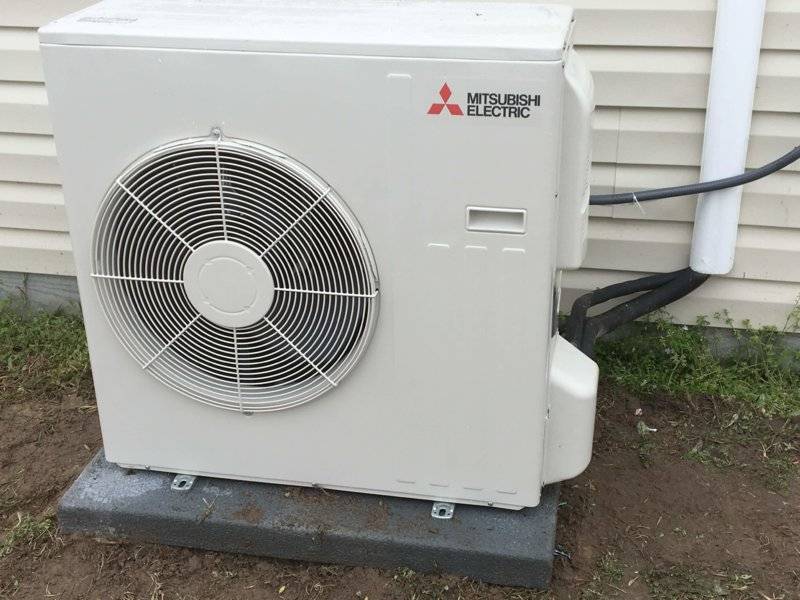

When I had central put in asked about it no was the answer also. A garage fire, car left running or a chem spill. I'm looking at a mini split ductless 18k btu. They wanted $5k for unit plus install, 5 hour job they said. At the time (2 months ago) could have bought the unit and accessories for $2,650. $2,350 for 5 hours work come on. I've run power to a cutoff box outside and put a pad in place. Looking buy the unit and mount outside unit on the pad and wall bracket to hold inside unit. Then hire a repair contractor to finish it. Even if I pay a guy a $1,000 to finish it that is a better deal.
When I had central put in asked about it no was the answer also. A garage fire, car left running or a chem spill. I'm looking at a mini split ductless 18k btu. They wanted $5k for unit plus install, 5 hour job they said. At the time (2 months ago) could bought unit and accessories for $2,650. $2,350 for 5 hours work come on. I've run power to a cutoff box outside and put a pad in place. Looking buy the unit mount outside unit on the pad and wall bracket to hold inside unit. Then hire a repair contractor to finish it. Even if I pay a guy a $1,000 to finish it that is a better deal.
Thats a crazy price for an 18k installed. I only paid $3500 for my 36k Mitsubishi installed.
Labor and taxes are high but $470 and hour, crazy. Had a guy price a cheaper ($2.350) mits unit 18k btu no hyper-heat and pan heater $3,600 with me doing cutoff box and pad. Was going to do it but he wanted $1.800 down when contract signed. I said you'll be paid the second your done and I'd give him 2 contractors I've used. Roofer $9,000 paver for my driveway $14,000, no money up front. He said I don't do that need the deposit. No thanks.
