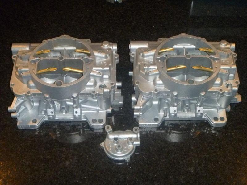

Here are the carb castings. The finish is very nice and certainly not porous like dry glass can leave them :sunny:
WoW! Those look fantastic! When I did my hemi carbs my guy used a #13 media dry and they came out very similar to yours (as best as I can tell in the pic). Best I can describe is the finished product had a sparkly look to them; not chalky or pitted like coarse glass or sand.
Finishes sound very similar to me Meep. They certainly are a little sparkly.

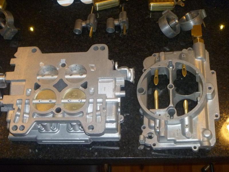

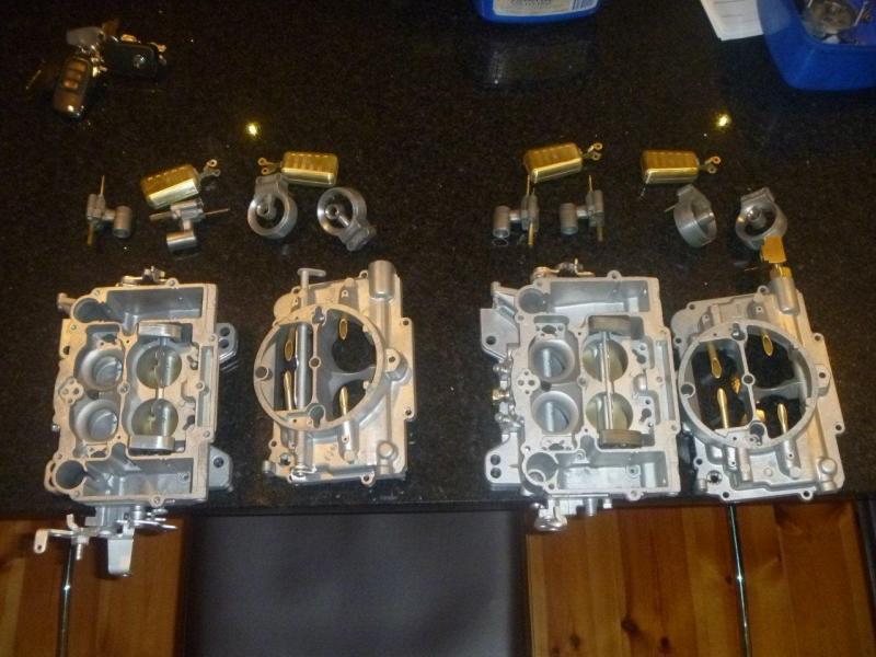

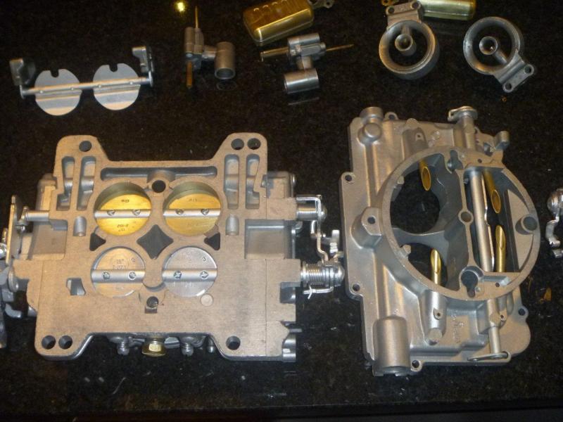

Getting this thread back on topic, I spent yesterday cleaning small parts like booster venturis and floats, and assembling carb bases. Of the whole caper, I was most nervous about reinstalling shafts and throttle blades, but it surprised me how straightforward it was. The blades are better centred in the bores now than they were when I disassembled them. I am enjoying doing this on the kitchen bench too as it is so bloody cold in the garage!! I hope to get close to finishing them today. If not, there's always tomorrow.
Beautiful! These are going to look so good when they are done you won't want to put gas in them.
Don't forget to stake the throttle blade screws. I give them a whack with a punch while supporting the screw head with a solid piece of bar stock. That way the force doesn't transfer to the shaft and bend it.

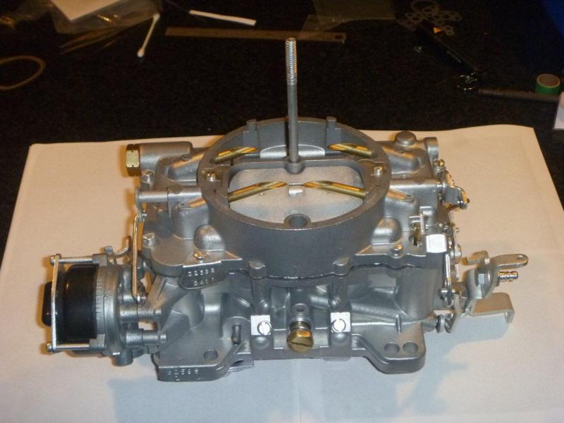

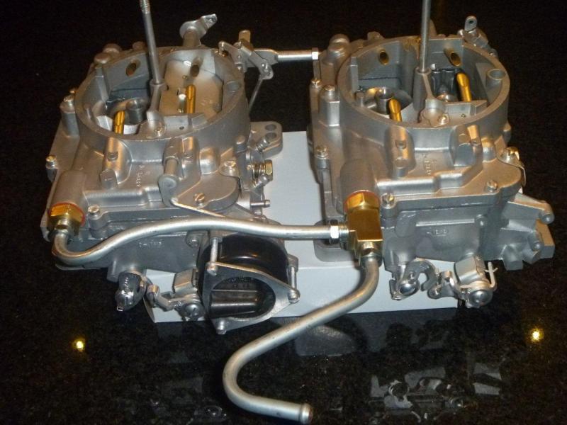

One carb done, one more to go -
The carb looks great.

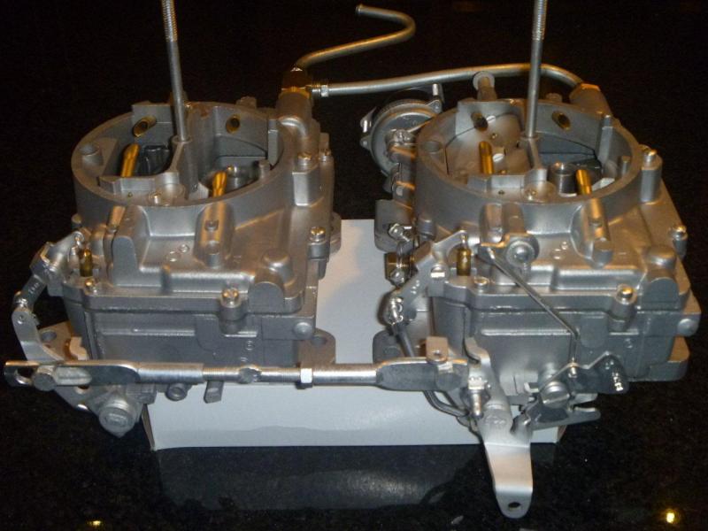

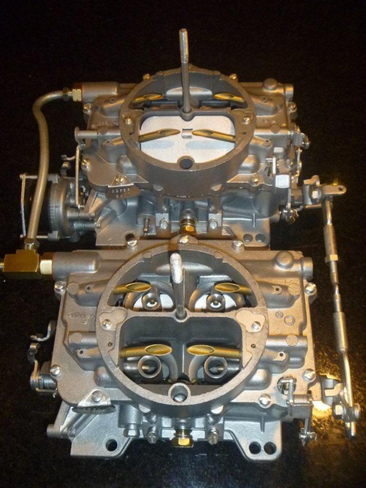

My carbs are done!!! Ain't they pretty? :love7: (Now I can get on with bulding the engine.)
Nice work Frank .They really pop .
Looking forward to your engine rebuild thread
A work of art indeed! They will make a nice center piece on the dining room table until you have to use them.
Thanks Meep. When I cleared the carbs out of the kitchen, I jokingly asked my wife for a hand to bring the block in to the kitchen to start assembling it - if looks could kill I wouldn't be writing this now:icon_lol:
