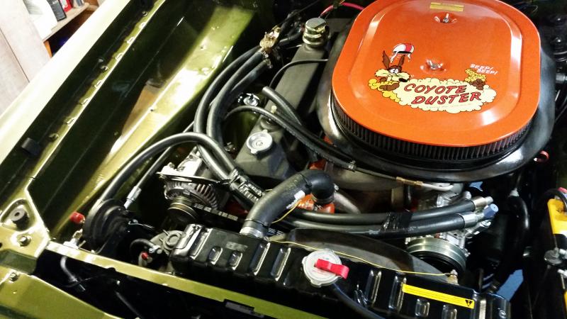

Here's one tucked away on my Dart's /6, using the factory regulator. Works great and only required grinding the bracket down about 1/4".
