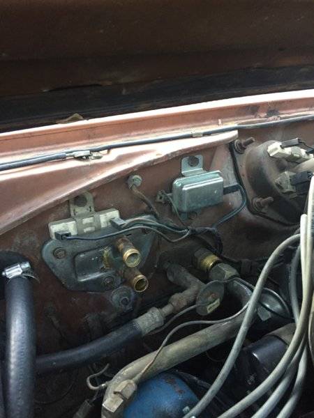

Geeeezzz.... i bought this car with a Mopar Performance distributor in it (see pic), but theres a 4 wire ballast on the firewall?
The 4 pin ballast resistors are for 5 pin ECUs.
You can use a 4 pin ECU with a 4 pin ballast resistor.

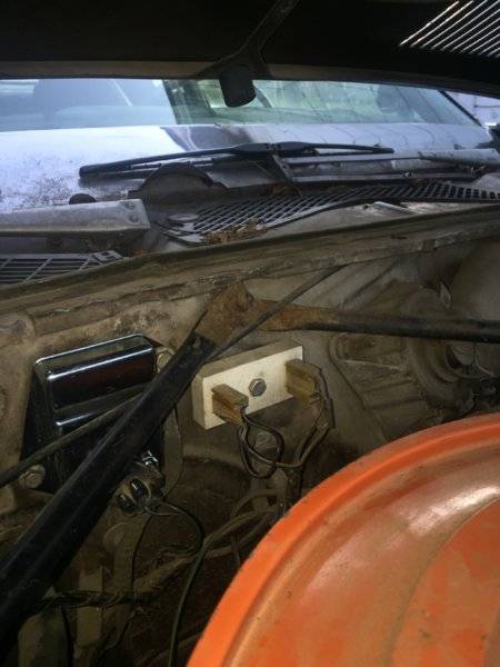

Yeah, I was just showing the factory stuff. I've never tried it without a ballast resistor so I can't really say amything meaningful about it. However, on the factory setup I think some rewiring would be necessary to eliminate the ballast resistor(?).

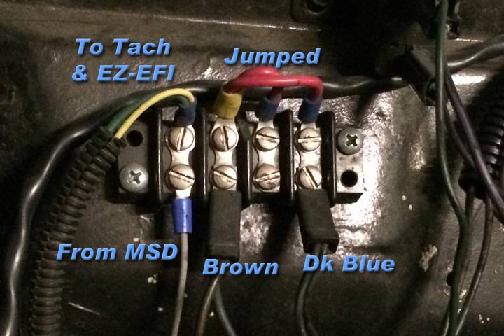

This is what I did until I rewired the entire car. I used the center wire for my electric choke when I had carburetors.
And for anyone who might say that this is/was a problem, it wasn't. But I only did this after I installed an MSD distributor and ignition and eliminated the Mopar ignition.
