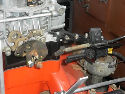

This is what I use for the swap & it takes the guesswork out
The throttle cable bracket & kickdown kit (Uses factory Chrysler cable) comes from Bouchillion Performance Engineering. It works with all combos that are used on our Mopars.
Even lets me use my Cruise!
thats quite the carb spacer you got there, is that a 2"
