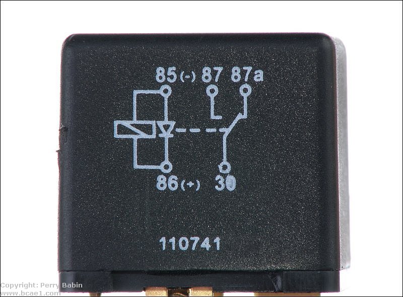

IMPORTANT CAVEAT!!!!!!!
Some "Bosch" style relays come with an internal diode across the coil. THERE DOES NOT seem to be hard and fast standardization for these, meaning, some can be reversed compared to others. If you wire one of these with the wrong coil terminal GROUNDED you can burn up your switching / trigger circuit, or at least pop the fuse in the trigger circuit.
CHECK these for a diode, and for polarity of the diode.
In the example below, DO NOT ground pin 86!!! with a 12V NEG ground system!!!
