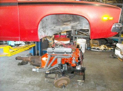

I was just looking at the pics of my bird and I don't know about that one. Seems like a total redesign to do coilovers.
The biggest problem I see is the shocks going through a pretty limited space in the K. The upper part of the shock attatches to the upper control arm mount. It's a rather short shock and not the same as the earlier cars.

As I was looking at it I didn't know if it could be done by looking at how big around most of those springs are and the length of travel for it without interference. I thought I had seen somewhere that somebody was making tubular uppers and lowers for these cars with the intent of running coilovers but I could be wrong. I am not in any big rush on restoring this car as I had a picture in my head of what I wanted it to be so a lot of figuring and thinking goes into it since everything for a b body gets listed like 68-72 or 71-72 only.

A little off the subject but is that a big block going into a small block car? Inner fender just looked like a small block car to me and I was wondering how tight it is?
Fricken tight. When I did this, nobody seemed to mention the whole "it's gonna be close" deal. It's what I get for working at a chevy shop.
If anyone wants some photos and dimensions to cut out the small block inner fender to big block like chrysler did it let me know. I have a bunch of photos and dimensions taken form a 73 BB RR GTX car. i cut mine out from the wheel well side and bought the rubber flap from year one. gives pl;enty of clearance with the headers and you can get to the spark plugs as well.

I don't know man. I could be wrong, but I don't think you have a 2.5 - 3 inch hole to put a coil over through. Man, now I gotta go climb under the beast and look.
