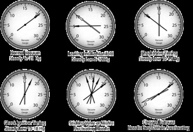

throw a vaccuum gauge on it. May be a sticking intake valve. Heres a chart for reference. You can tell a lot from vaccuum.Of course it will be low if you run a big cam.

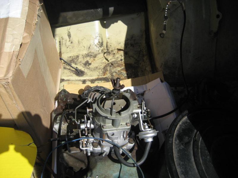

It's a 72 Coronet 318 2 barrel carter carb reman. with 904 trans with factory a/c setup. If you are at half throttle and go to full throttle it's ok. If car is at a stop or idiling and you step on it it backfire through carb 2 out of 3 times. If you ease into it it's ok.

Done pissing around with that POS 2 bbl. Just ordered 4 bbl intake and carb with electric choke from Summit. To bad they can't helicopter parts to my house.

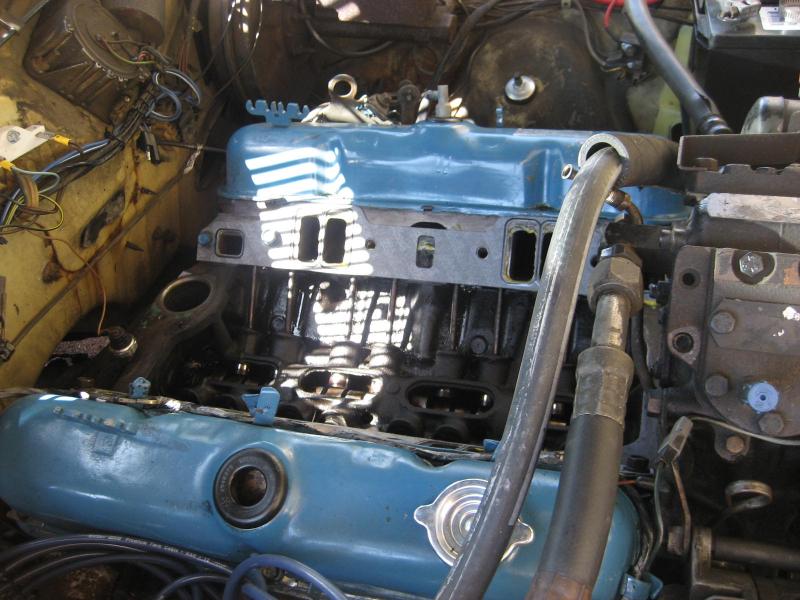

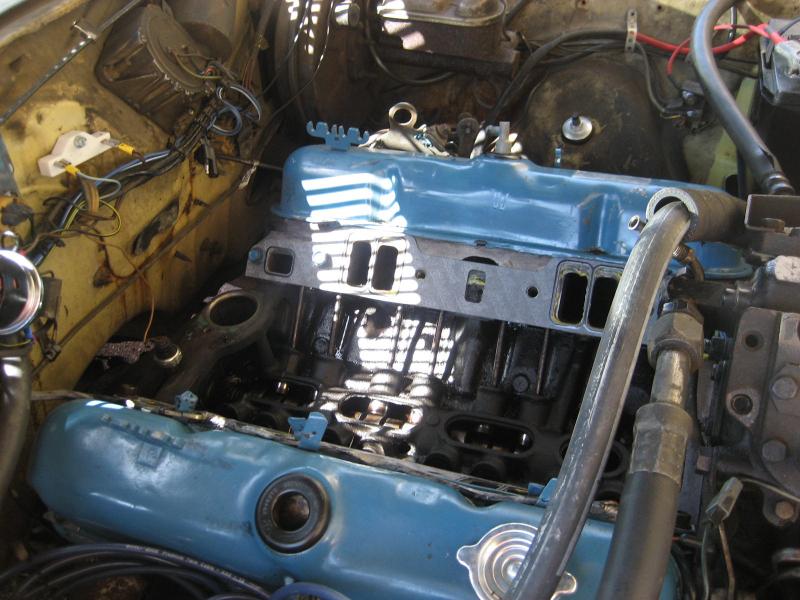

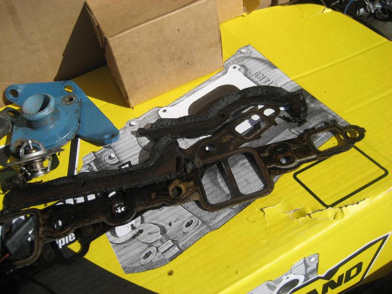

Had to get a 3/4 short pipe for thermostat bypass hole for 4 bbl intake manifold from Home Depot. Who new they sold car parts Apparently the one in old one in stock manifold doesn't come out. Not gonna say what it looks like screwed into new manifold. Why is one side stepped up on the inside of intake higher than other?
