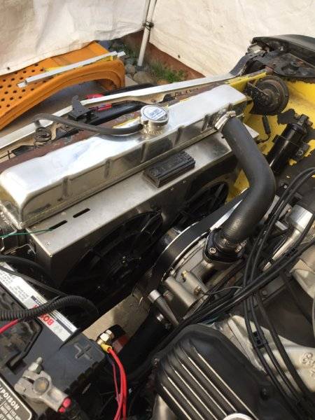

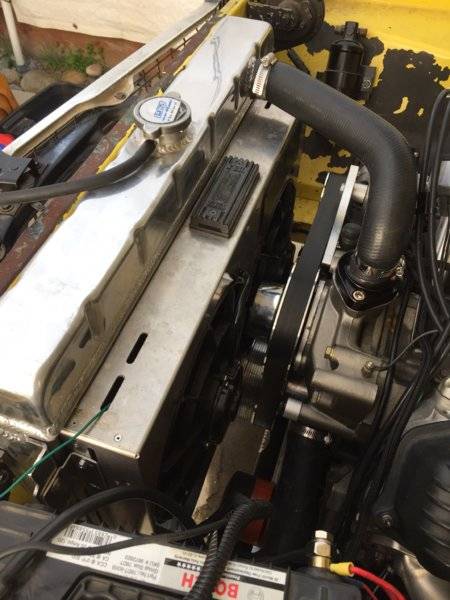

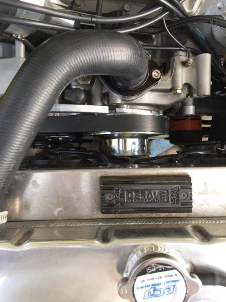

Spent today figuring out the cooling and I KICKED IT’S ***!
Power steering pump had to be removed and unless I go to a type 2 pump, power steering is out, manual to go back in.
The Derale dual fan set up fit like a glove. It works awesome! The PWM is very cool, ramps up slowly and also runs for a 30 seconds after shut off.
Don’t mind the messy engine compartment, things were done so I could test, it’ll be cleaned up. I have the temp set to come on at 187/188 and it cools down pretty damn fast to 180. I still need to experiment with the settings, but for now it’s good.

Forgot, the water pump pulley bolts self clearanced the plastic on the fan rib about .030. My eyeball thought I had room, but the reality was it wasn’t enough.

How much motor movement do you have aka rocking when you get on it? Or brake torque? Just asking since you said the pulley bolts self clearanced on the shroud.

The plastic rib on one of the lower fan shroud was a bit too close, I do have a 1/4” otherwise. Also running a Schumacher torque strap. That engine doesn’t move hardly any, but I’ll keep an eye on it.
