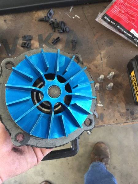

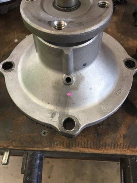

            Got the Flowkooler pump out and it was definitely leaking from the weep hole.
            So I jumped on Summit and got another coming to me. I’ll send this one back for a refund. I do like this pump cause it does MOVE coolant! The other pump I have, well, you couldn’t tell if the coolant was moving or stagnant.
