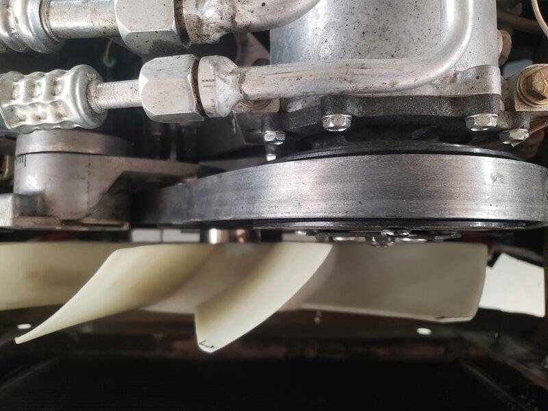

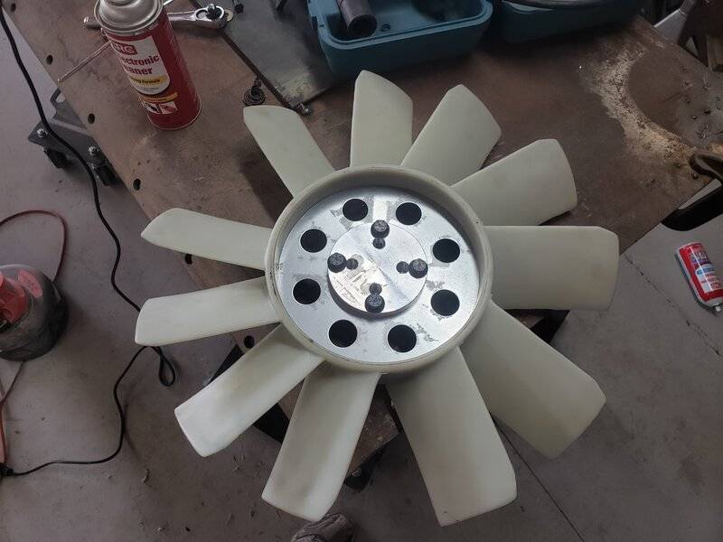

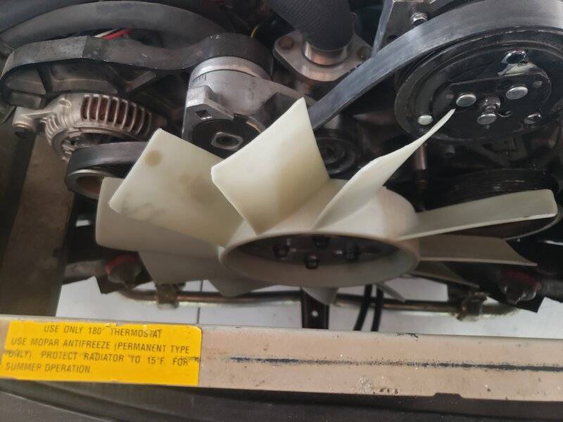

Might be fixed. A few more runs to make sure. Drive 50 mile round trip w a 10 mile 7% uphill grade in the middle in 110° temps at 70mph/2700 rpm. Engine hit 201° and needle in middle of factory gauge but mostly stayed at 195° or below. Had a piece machined that eliminates the fan clutch, allows a factory, not flex, fan bolt to the water pump. Used a nylon, reverse rotation, 11 blade, 19" fan from a Chevy truck w a 496 and my factory shroud. At idle and around town it gets up to 195 but that is about it. A/C still blows cold at 40° vent temps. Im going to do a bit more testing, but so far it seems to be working.
