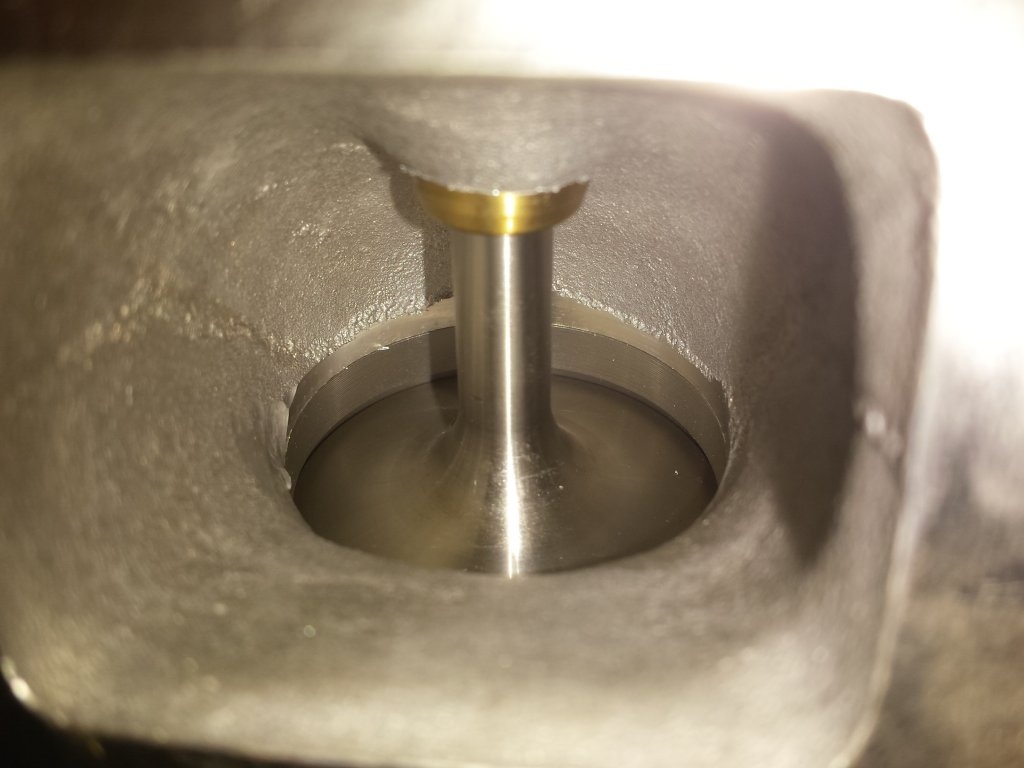

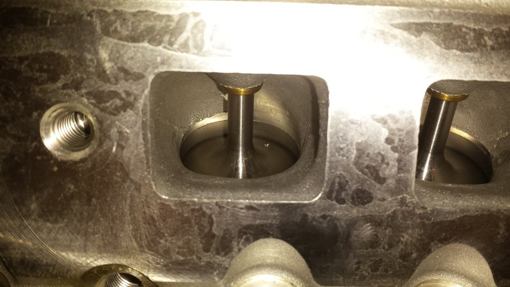

i went with Stealth heads on my build, i started with bare heads and had Hughes CNC port them a couple of years ago, they turned out real nice, but the bottoms were not anywhere near flat, i would not recomend running them out of the box without some inspection and work.

Stealth heads...

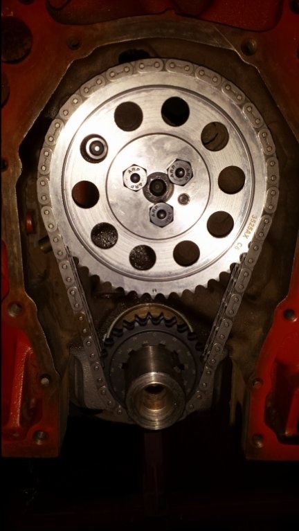

Here is the engine mocked up so far...
Summit billet timing chain and aluminum water pump housing / Summit stay cool pump.
