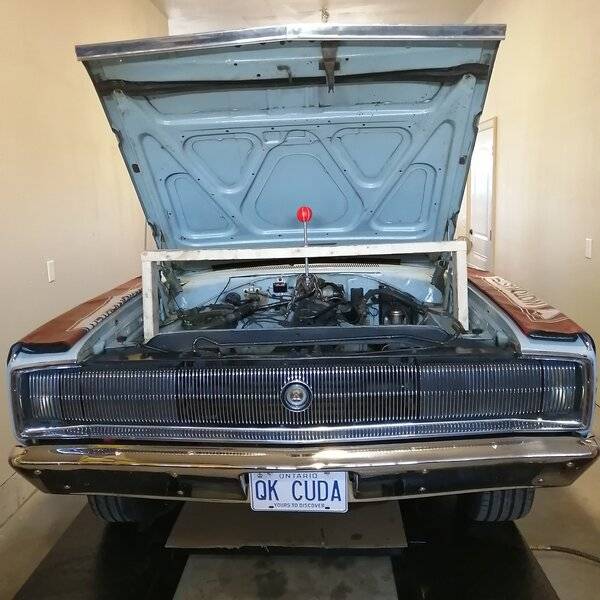

The hood is fine, there is more clearance than it appears. I put the ball on the rod just in case I close it too far when raising the lift.

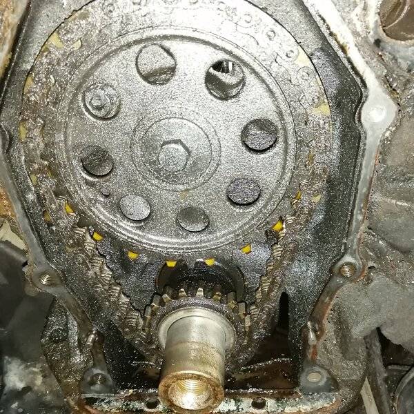

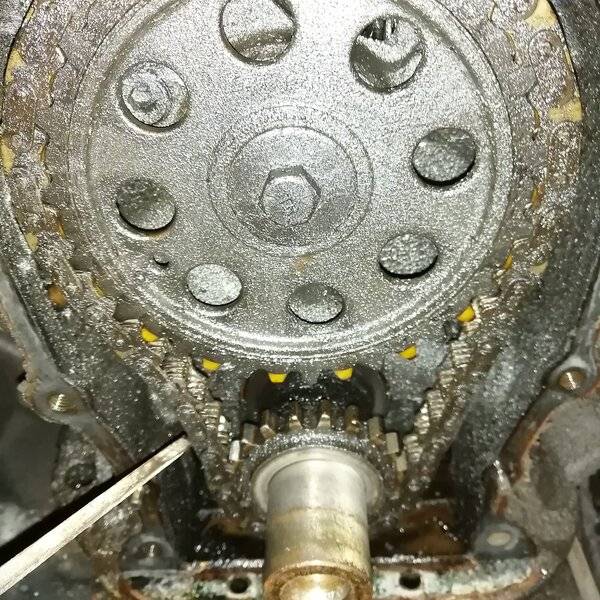

For those who didn't think they put nylon timing gears in 1966, mine had one. Fortunately it hasn't shed any teeth yet. It did have over an inch of slack.

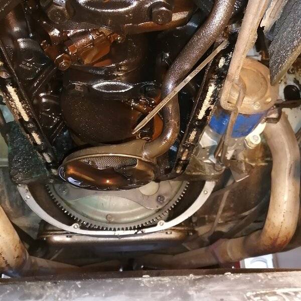

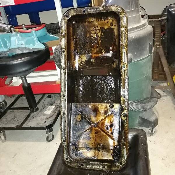

Got the oil pan off today. Cleaned the pickup and scraped the old pan gasket off. There wasn't much left of the cork gasket. It looked like hardened varnish and about as thin as paper.

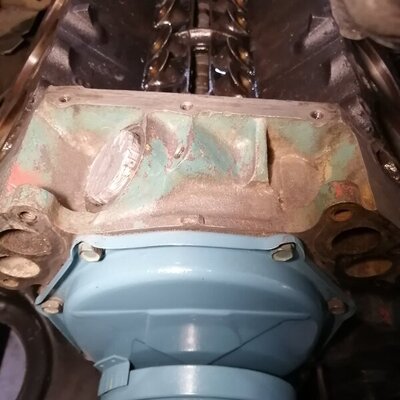

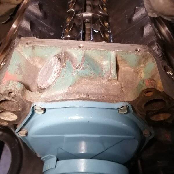

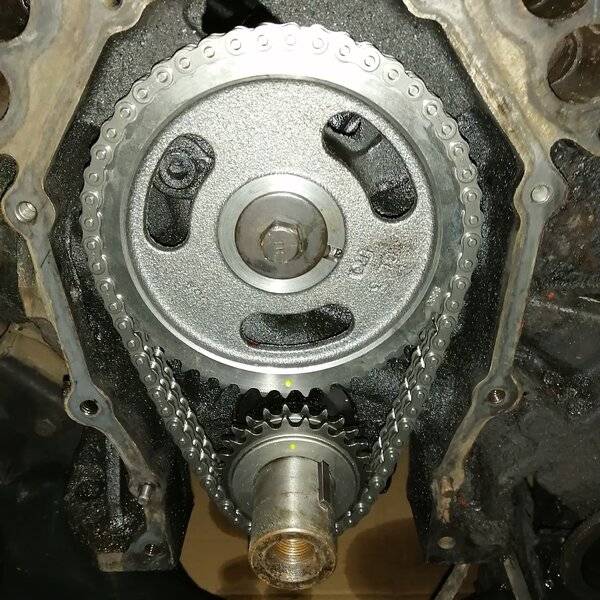

Cam is in. Got the condenser back in place and all of the supports and the grill reinstalled. Now I can lean over the front again.

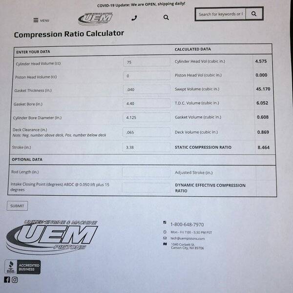

The machine shop just called back. After cutting the heads .020, they now measure 75cc's. Here is the calculation I ran, which shows just shy of 8.5:1 compression. The theory behind cutting the heads .020 was to make up for the fact that I will be using a .040 composite head gasket instead of the factory .020 steel shim. That being the case, it puts everything in the same relative position, and doesn't require any intake face cutting. Also the distance between the lifters and the rockers remains the same. The compression was pretty even across the cylinders except for the one with the bad valve, and the cylinder walls are clean, so I think the rings will be fine.

I would have done it the same way with the gasket/milling thing.
But when using closed chamber heads, going one for one with the gasket thickness vs the head milling...... you end up with a slight reduction in CR, since the gasket is the full diameter and the chamber is not.

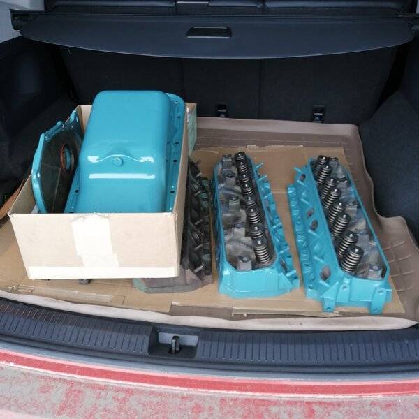

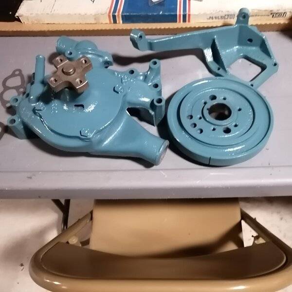

Picked up the heads today. More details tomorrow. I had them paint some of my parts at the same time since my garage is not heated. The second picture is the actual colour.

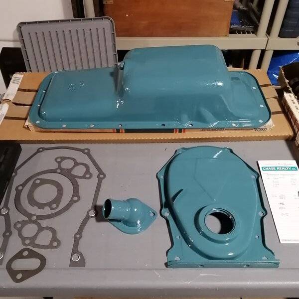

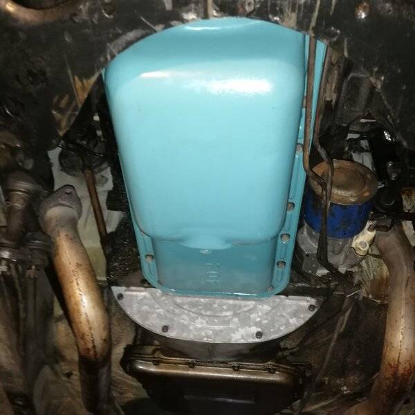

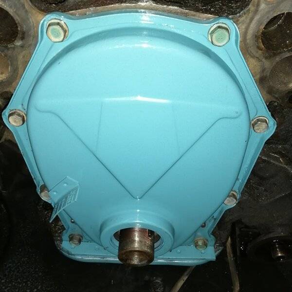

Got the oil pan and timing cover on. Spent the rest of the time cleaning parts and getting them ready for paint. Yuk!

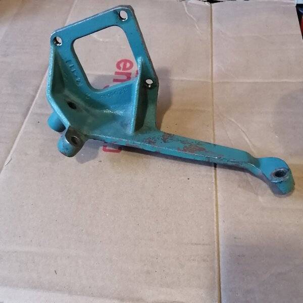

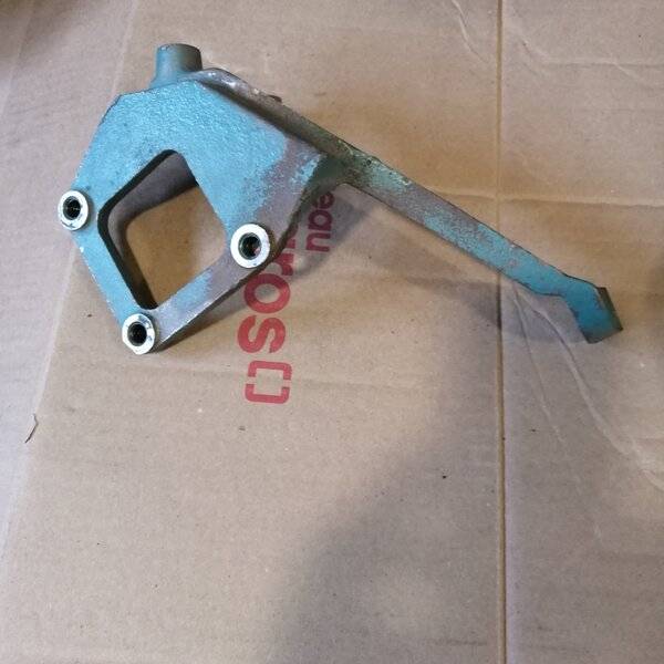

After cleaning it up it answered my question about the A/C bracket. Both sides were painted engine colour, so obviously the bracket was installed on the engine before it was painted and the compressor was attached later.

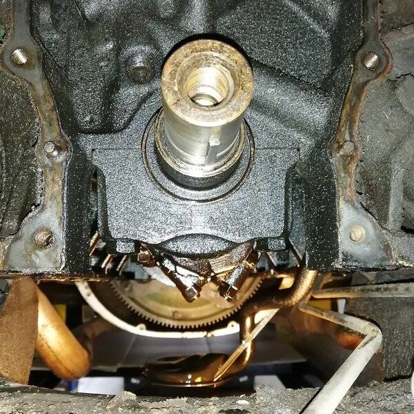

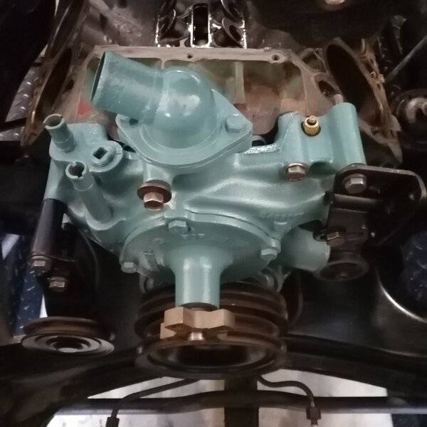

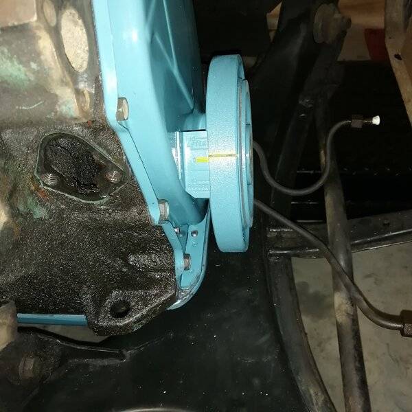

Finally installed the painted parts today. Crank was set at TDC and I tried not to move it while I put the balancer on. Looks like I am off a degree or two. The difference in colour is flash and no flash.

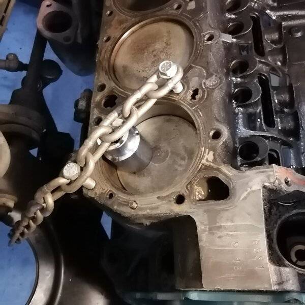

Had to scrape at least a half inch of crud off the front of the engine. Also spent way too much time cleaning and painting pulleys and brackets. When you work by yourself you have to be resourceful. Like my redneck piston stop, so I could torque the crank bolt,?
Full marks on the piston stop. But I don't think I would put a 55 year old damper back on.
The damper actually looked really good, no sign of any deterioration of the rubber.
