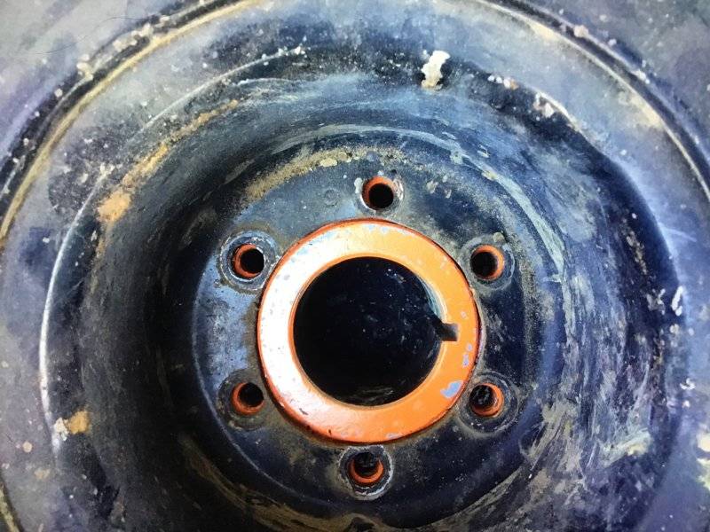

Here is one of those crazy things that I don't know which forum to put under. I'm trying to mount the crank pulley. Five of the pulley holes line up with the crank holes. Not the sixth. I have another damper, and all six line up. Before you say switch dampers, the extra one was in a garage fire, and I think the rubber is now dried up. Go with five? Elongate one pulley hole? Why always me?

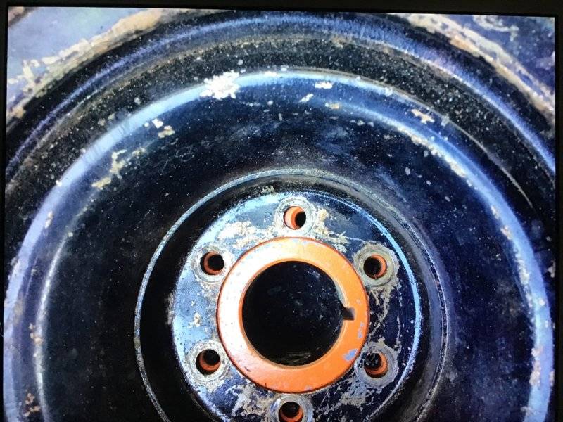

Does it look like this on the top hole? Then you can partially grind out the one hole so the bolt goes in.
Got my *** chewed off on moparts for these pics so let’s try to help someone over here.
The bolt hole spacing change is about the year not cast for forged crankshaft.
71518B55-FD32-4819-9A59-A75AFB493EFD.jpeg D98602B0-7009-4DA4-8709-5ABAE0410709.jpeg
Just saw your other thread showing a pic of the pulley in question. Before you go modifying it to fit the dampner, I would make sure it is correct for your application. You never did state what you are working on, but I have never seen a pulley with spacing like that for a Mopar from the late 60's to mid 70's.
