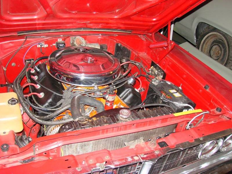

66 Hemi Bbody cars have the wiring for the starter relay and battery cables mounted on a plate ontop of the drivers side inner fender verses next to the master cylinder like a standard B engine harness is.
Sell the Hemi harness and buy the correct one. The Hemi harness sells for $235US and also has three wires in you won't need and the starter solenoid wiring is the wrong lengths to work with a firewall relay.
Yup: Thiis is a 66 Hemi, note the fenderwell mounted relays.
