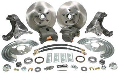

Personally, I wanted something a lot lighter.
I used the stock drum spindles and bolted on a set of Wilwood Pro Street brakes up front and used an AREngineering adapter and truck master cylinder. Dropped a ton of weight (aluminum hubs) and they stop great. Less than $750 in the whole setup.
I've also done the Viper (brembo) calipers and 11.75 cop rotors on a drum spindle. It's all on what end use you have in mind. AREngineering makes great parts for different applications.
