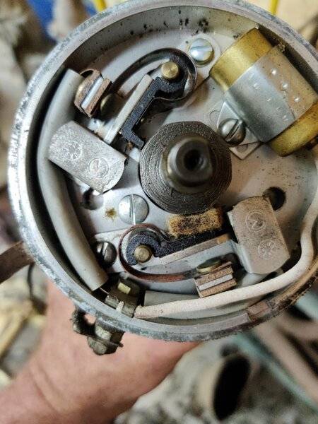

What is a 2444814 1967 Hemi Dual Points Distributor worth?

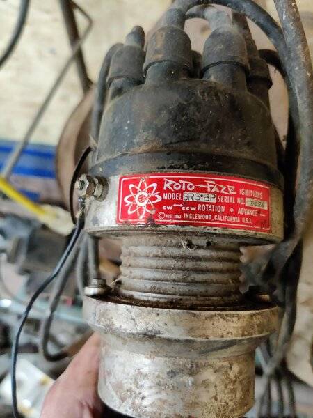

Would you go with buying the above-mentioned or a Roto Faze SRS-8P dual points? Which is better? 1966 426 Hemi build.

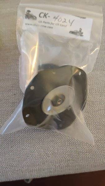

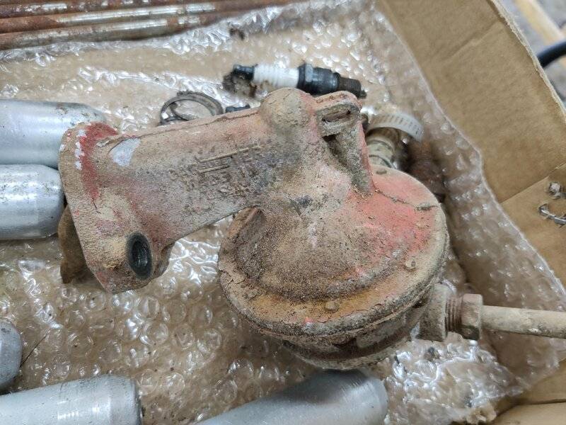

I also got a rebuild kit for my fuel pump and will be rebuilding it. One question I have is, Was the fuel pump installed before or after the engine was painted? Would the Fuel Pump be natural aluminum color or painted like the rest of the engine? I've seen it both ways on cars that have been " Restored".

Where did you get the fuel pump rebuild kit? Thanks
The guts are clean how about shaft wear?
Not familiar with that rotor faze, looks like mallory points. A hemi core in good mechanical shape around 200-500 then add lead, points/cond, vacuum advance, and probably springs another 4-600 easily.
