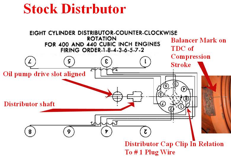

Dave's post is very helpful to your issue. Why your harmonic balance does not align to zero timing mark is unknown and you need to provide more history as requested.
Once that is fixed you have to merge two things after you ensure your oil drive slot is as pictured above. You need to see where your distributor vacuum canister aligns to not interfere with any engine items like fuel lines etc... and then the rotor position is adjusted to be just before a plug terminal, or for points just opening. Where the rotor points has to be the #1 plug wire and you install based on that. You rotate the distributor to get it right. Then once started actually set timing.
If oil drive is not right the #1 plug location will be different. If the shaft is not OEM correct and the tip is clocked different, the position will also be different and lastly if the cam stop slot for rotor is not right, the position of #1 will also be off from a typical OEM position. Knowing what distributor you are working on helps here. For example a Prestolite type can have lots of variations with mix and matched parts. Shafts and cam stops where clocked very differently between models despite the fact that they could work in other distributors.
