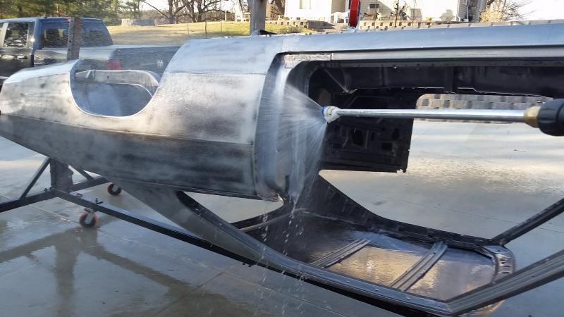

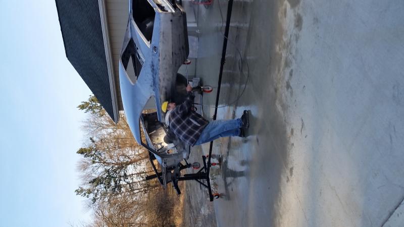

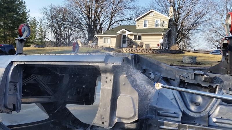

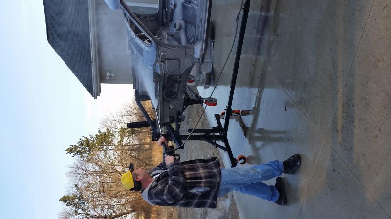

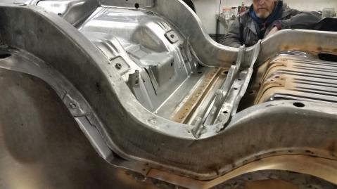

Yea it does, thank god my shop is well insulated, makes a huge difference, i remember changing a trans in a 66 olds in my dads driveway back in the 80's in a snow storm, really wasn't as bad as it sounds, piled snow up around the windward side blocked most of it, Had to get my car goin to chase some tail around on the weekend. thats when i could lay the tranny on my chest an lift it into place holding the tail shaft with my leg, and fumbling to get two bolts started in the bell housing, and say those were the good ole days. What really is gonna be fun is the day before i take it to be dipped I have to powerwash the car to remove the water based rust inhibitor. so I gotta wait till it gets above freezing, I do have drains in my shop but I dont want to wash everything inn there to, but i do have a big roll of plastic, maybe i can build a tent.

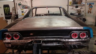

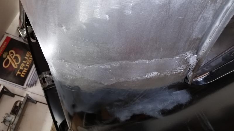

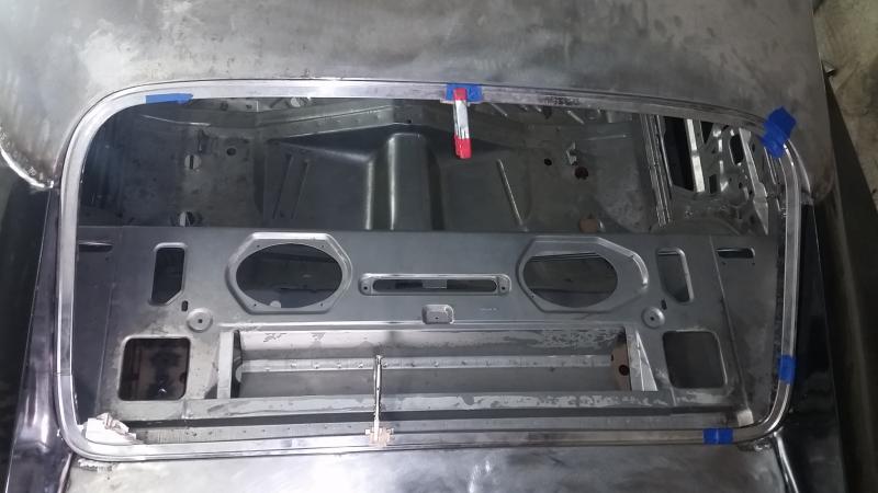

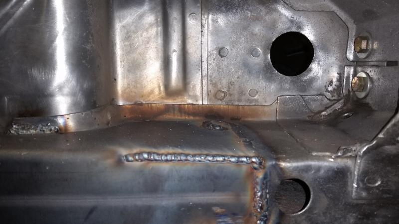

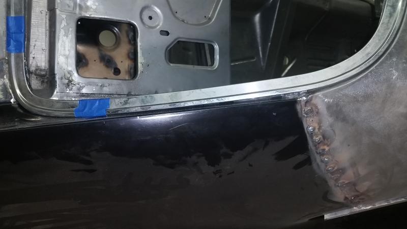

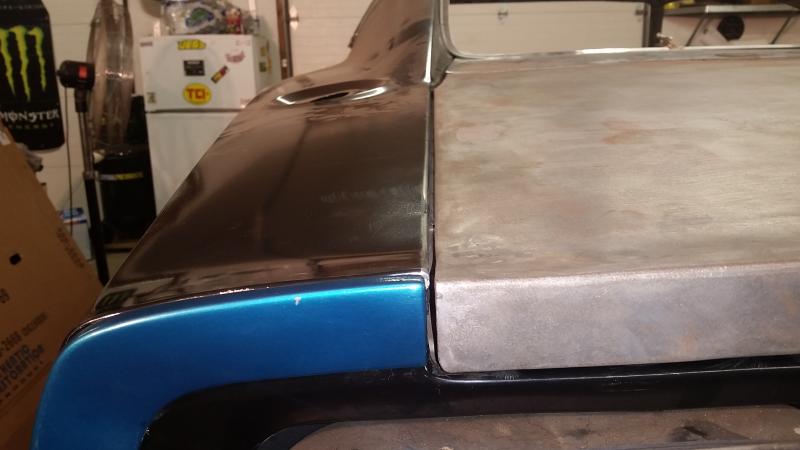

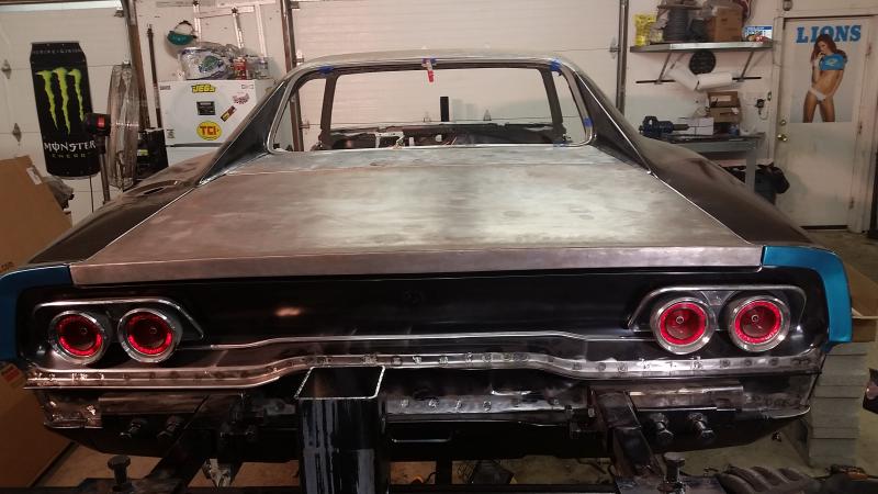

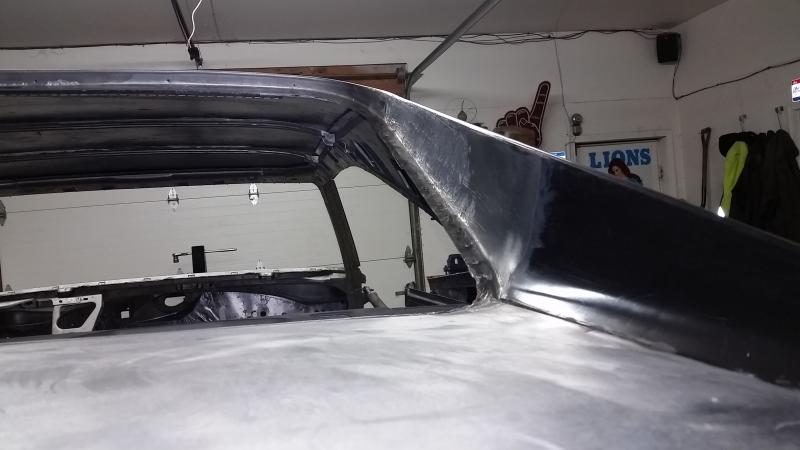

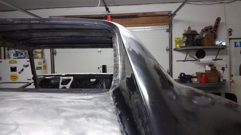

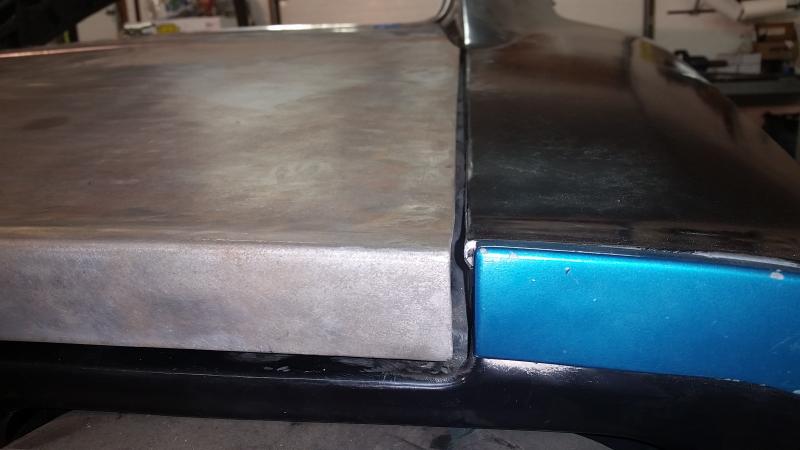

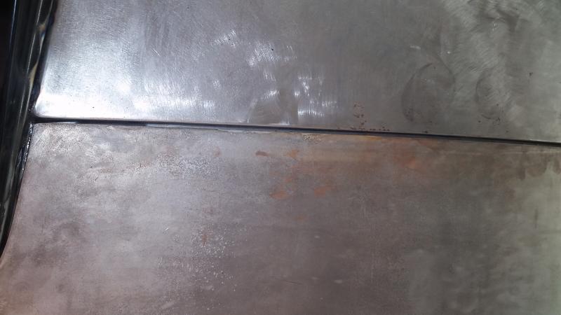

ot the passenger side rear quarter adjusted sightly to even out trunk lid reveal, persistence pays off, having the internet, and especially all the mopar guys posting there fine work here at fbbo sure is a blessing, would be nearly impossible to pull this off without them. The back glass fits!! taped the chrome trim together and did a rough fit, came out suprisingly well. have a gap at roof to sail panel contour on passenger side. I talked to a guy I know thats done a few of these, he said to definitely lead in these areas because of the stress, makes sense i was gonna lead in the quarter tie in areas anyway. Also he said to do the body work first, before epoxy, so I've researched that, think I will get it dipped first then use ever coat products to bondo over the epoxy, then prime. I'm looking for this paint to last a long time it wont ever see winter, might get caught in a rain storm, and will always be in a heated barn, probably going with ppg paint viper silver. Any thoughts?

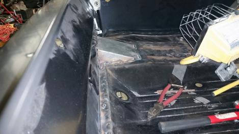

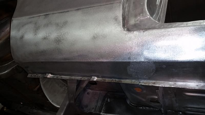

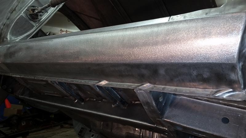

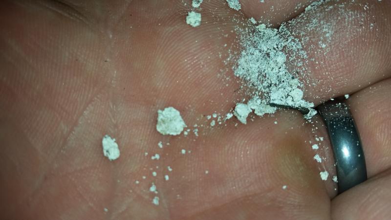

k extensions meet, also rockers. i bet i shop vac a couple of gallons of stuff out.
