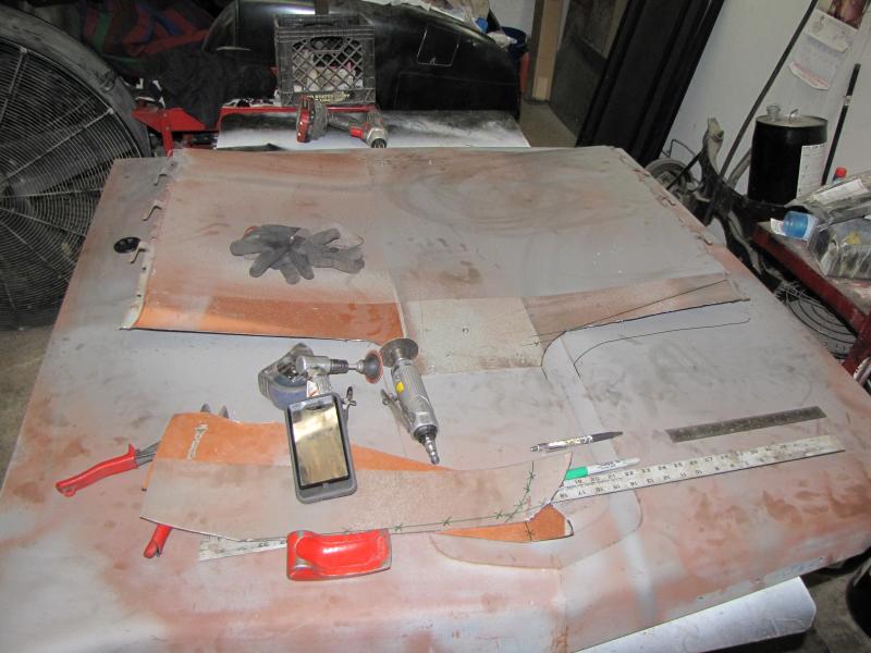

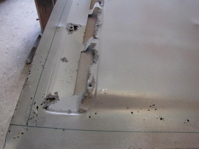

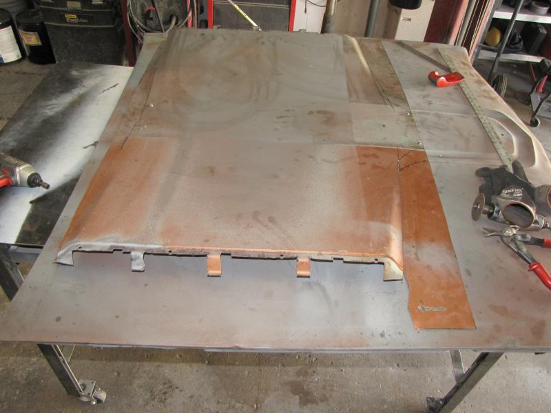

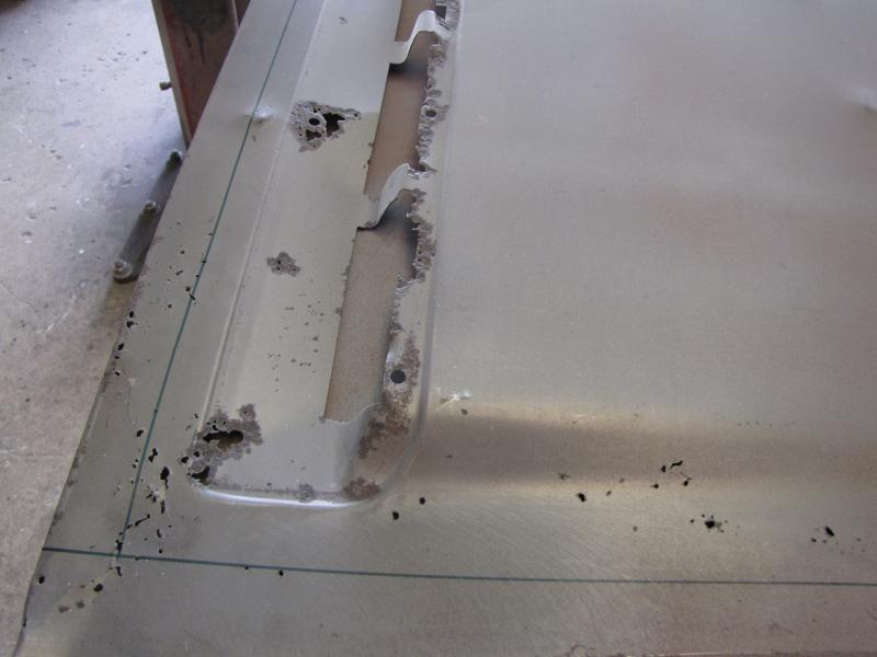

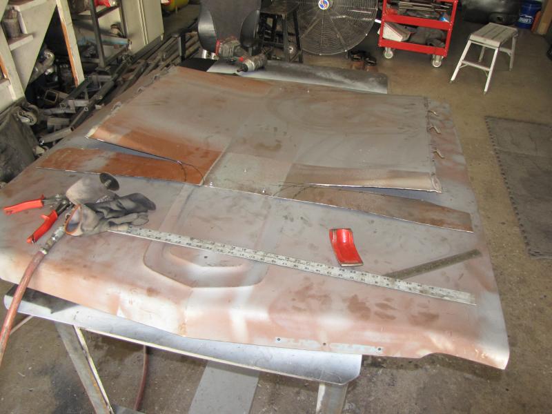

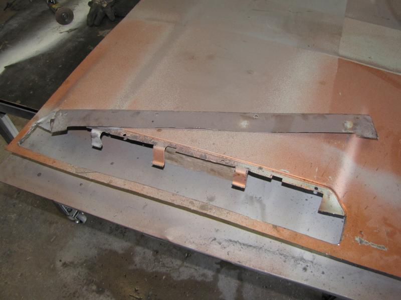

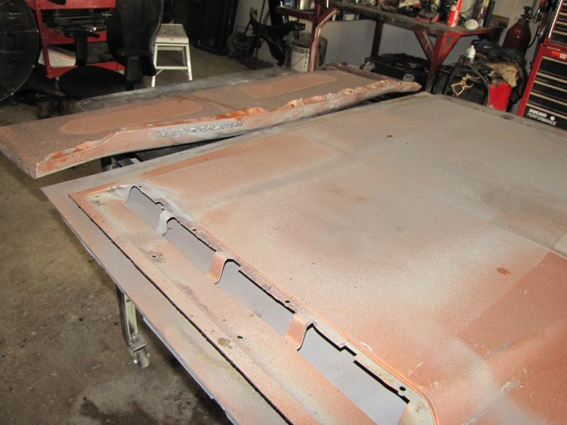

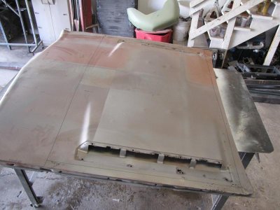

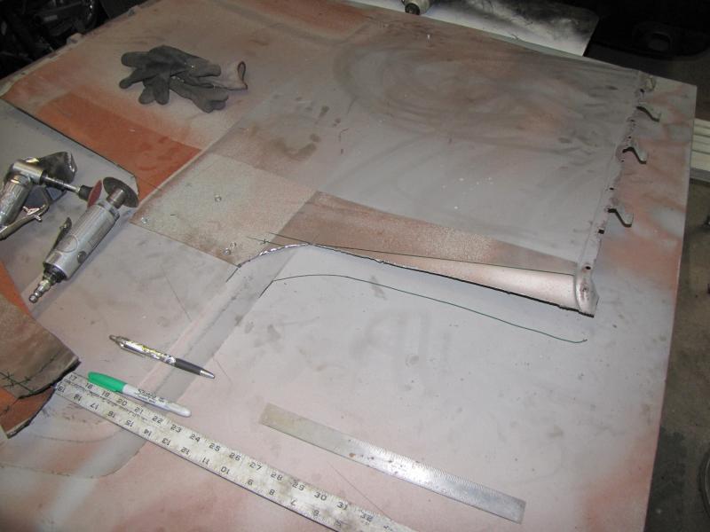

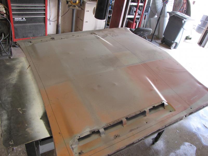

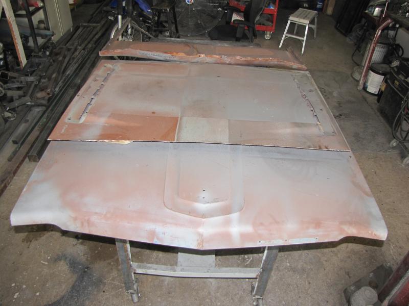

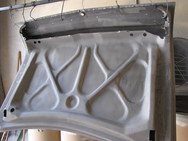

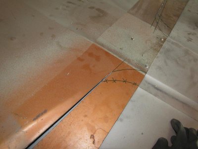

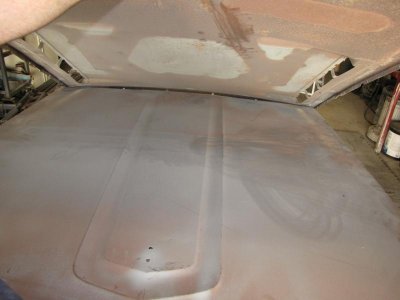

Had some time this afternoon, and got after these two Hoods. One is a RR Hood I got from Texas Acres before he went out of business, (thank you AMD for making NEW stuff), this RR Hood was junk, especially after I blasted 1/3 of it, holes everywhere, but, this is how the world was pre-AMD! Anyways, the pics tell what I'm doing, bottom line; merging a 68 (or 69) Satellite Hood (this one was also from Texas Acres, but this one is super good condition...I'm not using my original Satellite Hood in this process, it's standing by) with the raised call outs organic to the Roadrunner. Look, and enjoy! I'm not entirely sure which way I'm going, but, I think after these pics were taken, I sorted out what this is to look like. I'm raising the already raised RR Hood fresh air intake to about 3", which, will look pretty cool!

Wow that TRULY is some amazing work and what your doing with the way the regular hood looks if your incorporating those "RR bulge's" to it is going to look super good! Ive seen other "scoops" put on these hoods but this idea is killer with killer looks to go with it!! I cant wait to see how this hood looks in color! You could be starting the next trend with this idea!!!
Thanks Ron. There's a few folks playing with this sort of modification. I think as the stuff gets older and in worse condition from rust etc., doing these sorts of mods is needed. But, I'm actually really anxious to see this develop, and, will certainly post pics!
Can't wait to see what your hood looks like when you're done with it.

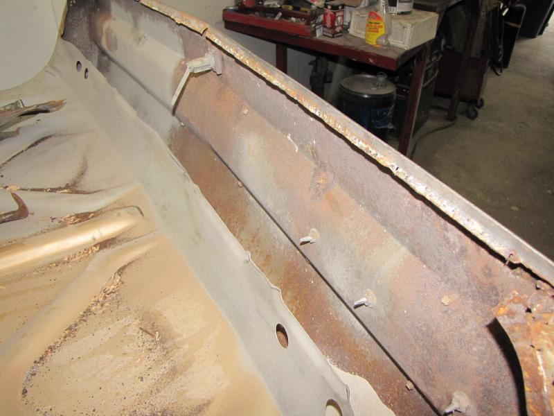

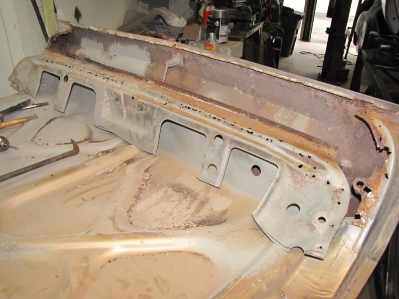

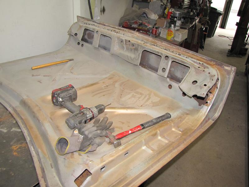

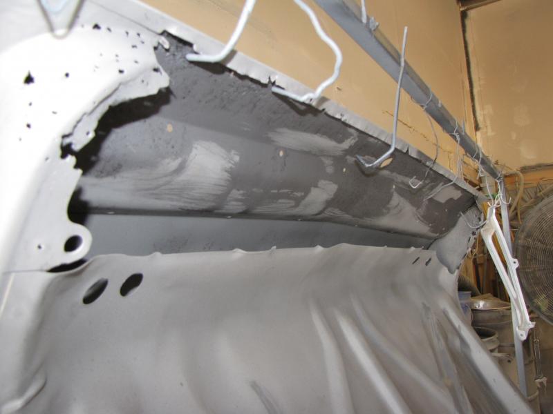

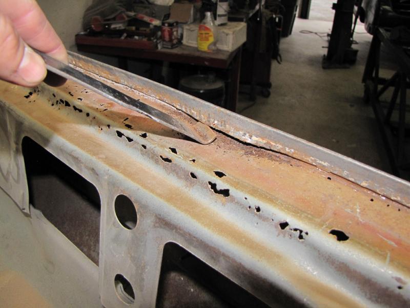

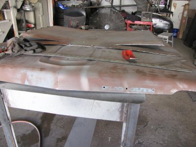

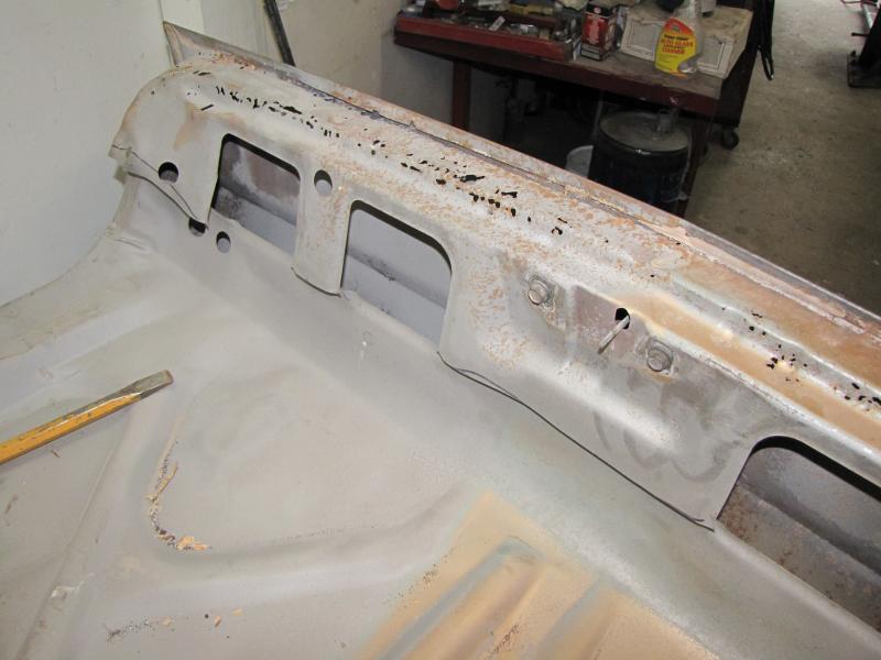

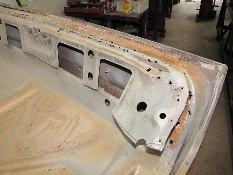

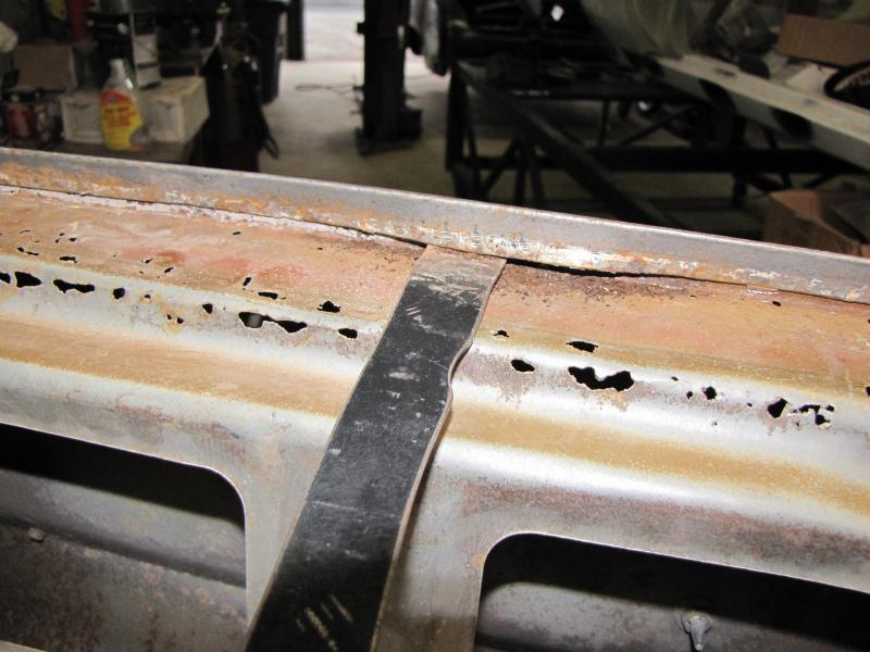

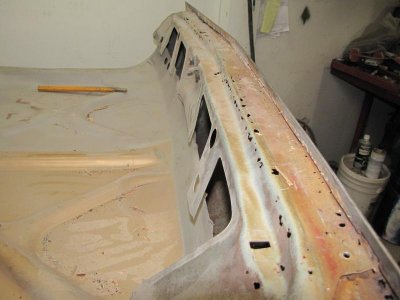

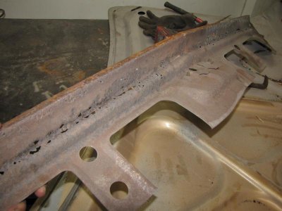

Had a little time this afternoon later to mess with the Deck lid off this car, after blasting it, and since these are not repopped, time to cut out the bad area and start to repair it. Intent and end state is mesh a few new pieces of sheetmetal on the back side of the removed piece (after I blast it and epoxy prime it) and bond the two together with the 3M 8115 Bonding agent stuff -- same thing I did last year on the Javelin Hood. But, I had to dig at it to get it to come apart. Man, the rust that hid inside this lip, amazing, rust truly is amazing crap!

Good timing on the pictures Donny. I've got to do the same thing on my deck lid.
Hope you're back at it soon Donny

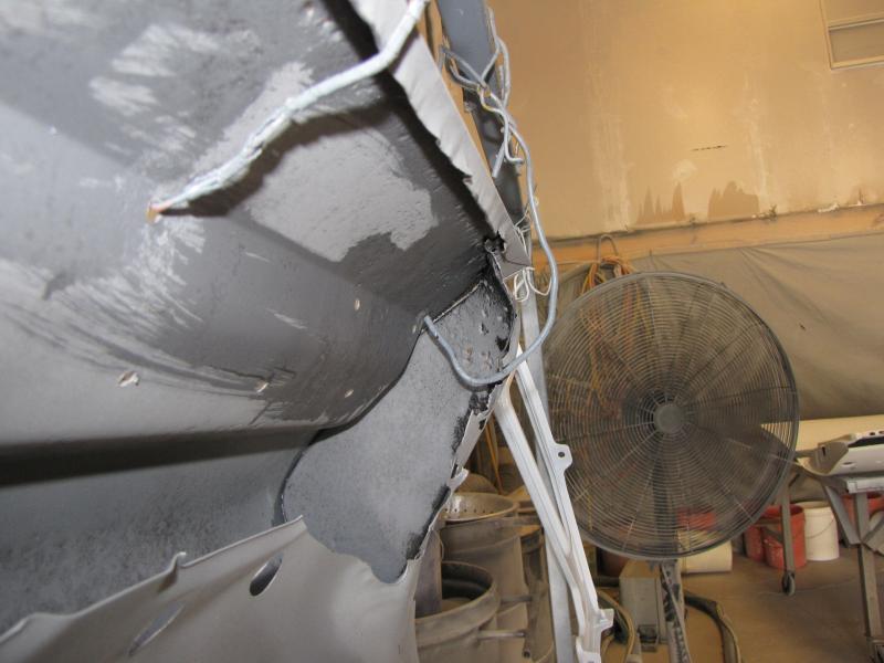

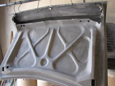

I blasted the Deck Lid a few days ago, and got the inside sections. Could not break all the tight rust up, so, Ospho the remaining rust. I'll Epoxy this next week, and put the Lid back together with minimal welding. 3M #8115 Panel Bond is my now go-to choice for many formerly welded applications. The stuff is fantastic!

I watched some 3M panel bond vids on youtube, that really is some cool stuff. Looks like your making progress!
