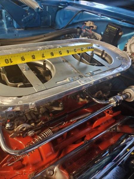

Carb stud to carb stud is 8.75"

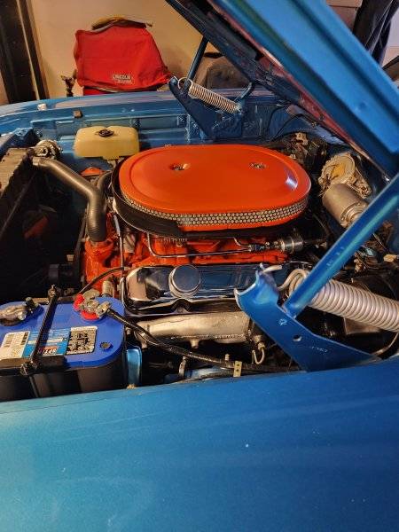

I have ordered a air cleaner assembly from chryco. Once I get it, I'll let everyone know how it fit. Going to have to modify my fuel lines for sure. But everything else should work as is. Added a decal to my generic oval air cleaner for now
Got may air cleaner assembly from @Chryco. Had to make my fuel lines come in at a 45 degree angle to clear the base plate. The base plate also hit the rear fuel bowl on the left side. I used some .75" spacers on the air horns and everything bolted up.
Now i just need to get a larger 440 magnum 8 pack decal made
