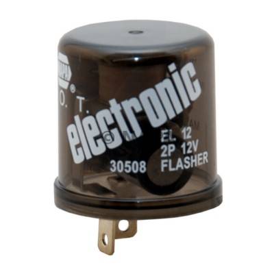

Thanks for the replies. I had to pull out the front bench seat to even get on the floor under the dash. I've got plenty of room now and have run my hand everywhere possible without removing the a/c ductwork. I still cannot find either flasher. I did a lot of searching on other posts n saw that a "weak" turn signal flasher will have the symptoms mine has. I've ordered 2 new flashers. Now I just need to find the old ones. The descriptions are appreciated but are similar to the manual. And "on top of the ash receptical" is impossible for my hand to get up there. Hope that's not actually where 1 is at. I need an 80 lb grandkid who can crawl under there for me n find it!!!

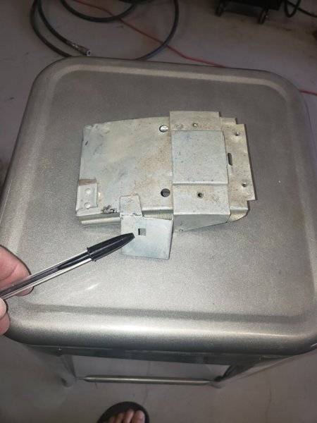

Ok, great suggestion on the turn signal. Listened to it and it is coming from glove box area. Unfortunately, completely covered by factory a/c ductwork, only a 1 inch slit between bottom of dash and ductwork. Had to pull cover for ductwork, then 2 fingers to grasp it and finally get it out. Now to find the emergency flasher. Red wire goes into a bundle wrapped in black.
Ok, found both. Both behind the panel that covers the a/c ductwork on passenger side. Both attached to the lip w a small clip. Turn signal is supposed to be attached to the side of the ash tray per service manual. Not even close. Well turn signals work now but emergency flashers still don't. On to the switch and spark chasing for that.

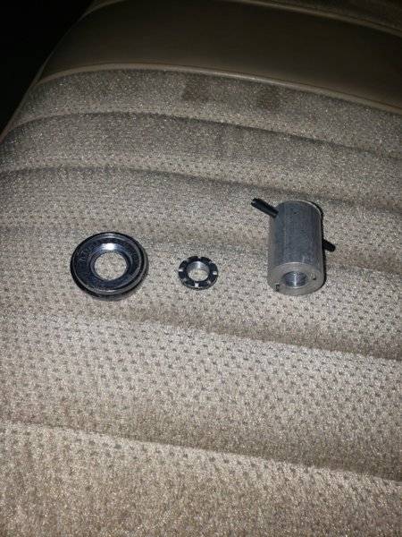

Does the emergency switch bezel nut require a special tool as the Service manual says or can it just be twisted off?
Answering my own question. Yes, it does need special tool. Same one used for antenna.
