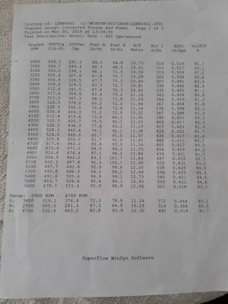

And what the heck here's a picture of the results from the dino anybody know how to read these things I figured out the important numbers

No, there's a lot of info here. We have found that running on a Dyno is preferable over a stand for braking in, and your post shows us what we might expect to see when hiring a Dyno break in service.
