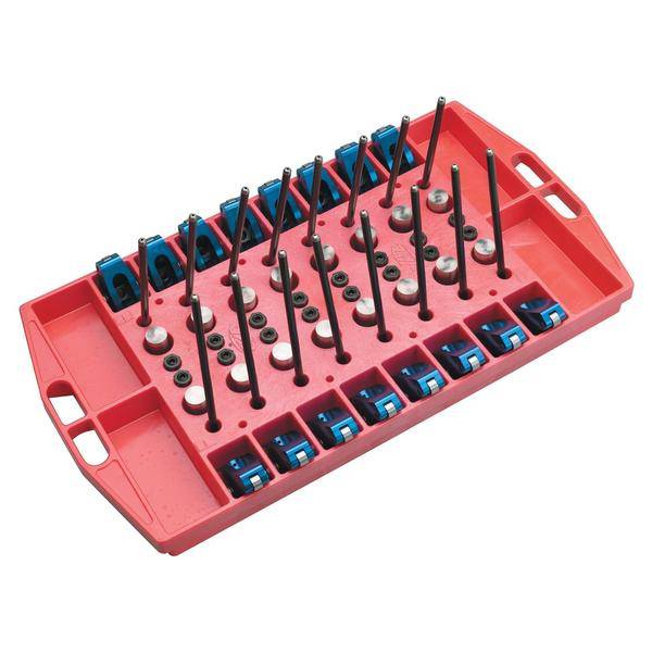

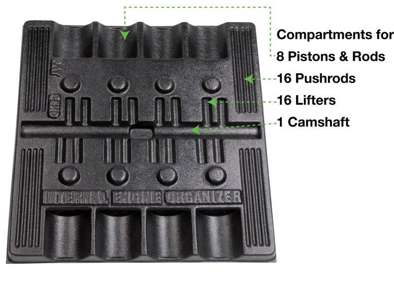

One of these would help you keep it in order. https://www.summitracing.com/parts/...MI9Zvw56aj5QIVBIzICh3odQcaEAQYAiABEgLa_vD_BwE
