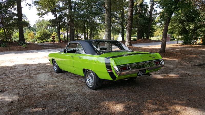

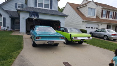

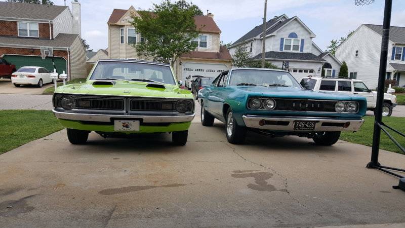

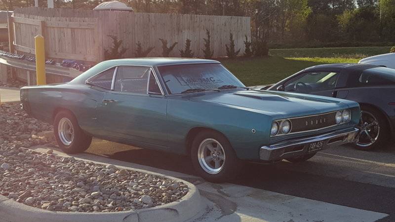

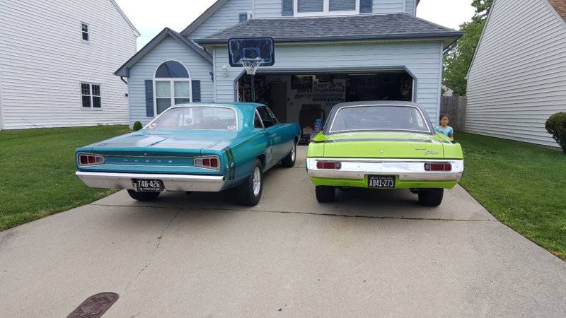

honesty couldn't tell ya, my dart was sporting worn out factory springs with air shocks and my coronet had factory springs with ridiculous shackle extensions. I didn't take any measurements before or after ..... but I have current pictures ...
20180908_105959.jpg 20170410_074246.jpg 20170422_103034.jpg 20170422_103059.jpg 20170422_103051.jpg
So it looks like your cars are about level with SS springs....thought they would give a decent rake....
