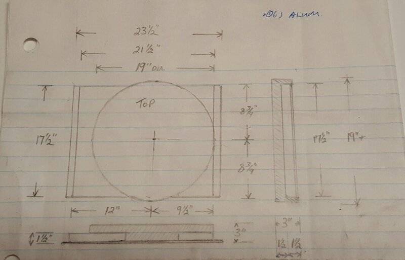

I didn't have access to a tig machine so I drew up what I needed and had a local shop fab mine for a little over $200.
https://www.forbbodiesonly.com/mopa...up-new-residence.114133/page-9#post-910710888
Here's the drawing for my 22" radiator.

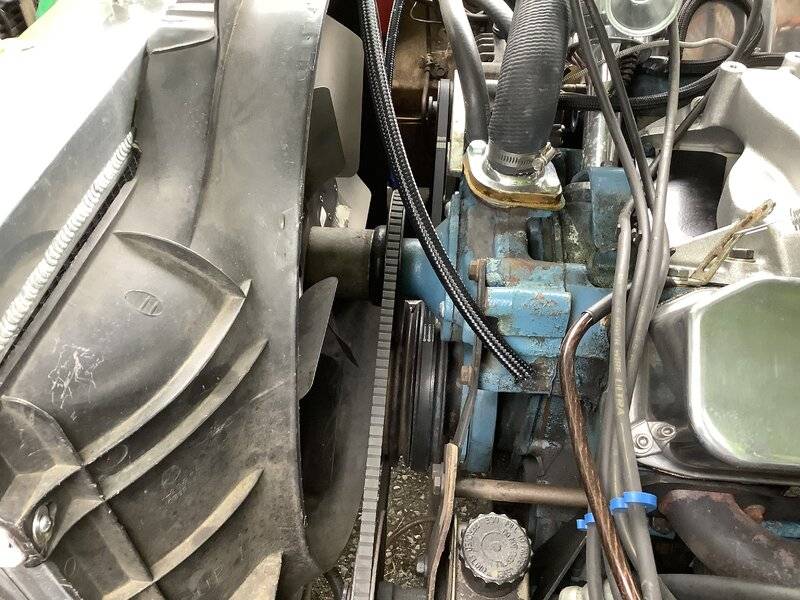

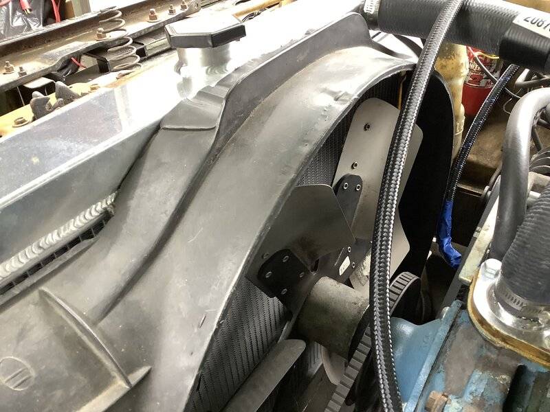

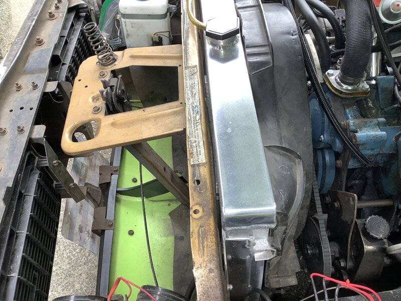

I used the original fan shroud on my 74 Charger and it bolted right on to the champion 26” aluminum radiator. Steel flex fan and 180 thermostat. Temperature runs 185 regardless whether sitting in traffic, idling in the driveway or cruising. Simple and efficient. Just my opinion and experience and that’s all.
