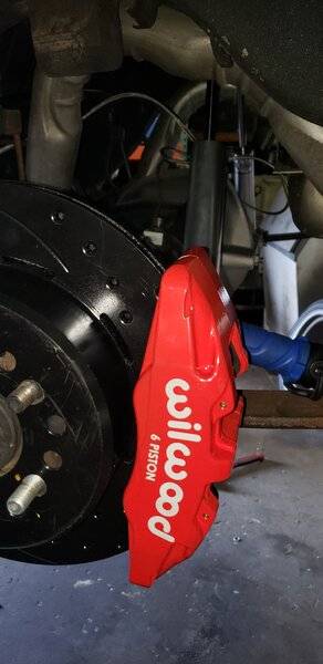

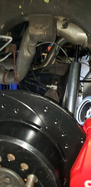

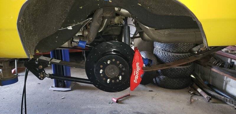

While I was there, I got a couple of new pictures.
My 6 piston Wilwood rear disc brakes are going to be finished today. Fronts and master cylinder, adjustable prop valve already in.
