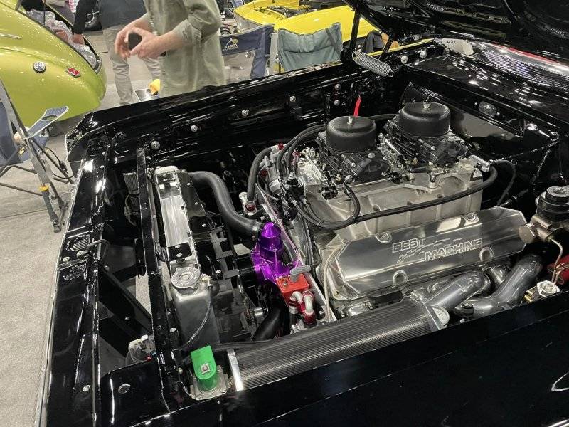

Ernie Miyamoto from Motofab inc. 2 1/8" - 2 1/4" stepped, 4" collector. It'll be interesting to see how it runs vs mine. His is 540" vs my 580". My headers are 2 1/8" with a 3 1/2" collector. Both have similar compression, cam, carbs, intake. He has 572-13 heads vs my -1's. His is an 8" converter, mine is 9 1/2". Both 4.10. 1 run 10.5x31. His is 10.5x29.5. His motor should keep making power past my 7000.

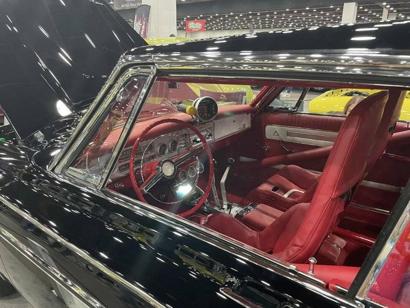

What Johns Dodge has going for it; KB aluminum block vs my 275lb Mega block. John weighs 140 to my 200. Front and rear glass bumpers, glass fenders vs my steel bumpers and fenders. Kirky seats are 8lbs lighter than my Homemade seats.
What my Plymouth has going for it; Car itself is 4" shorter. Sedans are lighter than H/T. Chrome moly cage vs d.o.m. steel. 5 gallon cell vs 15 gallon. Steering shaft and strut rods are tubing. Billet Specialties wheels vs cast Torque Thrusts. Rear window is lexan vs stock glass. Carbon fiber lift off hood vs hinged fiberglass hood. Mine doesn't have a backseat, console, front window regulators, or pot metal gauge cluster in dash. The cars are virtually identical otherwise. His physical weight along with the block, fenders, bumpers, seats, and block give him roughly a 280lb head start. We will weigh both on the same scales in a few weeks. It could be very close, maybe even lighter. My bet is I'll be about 3290 lbs with driver and full 5 gallons of fuel race ready.

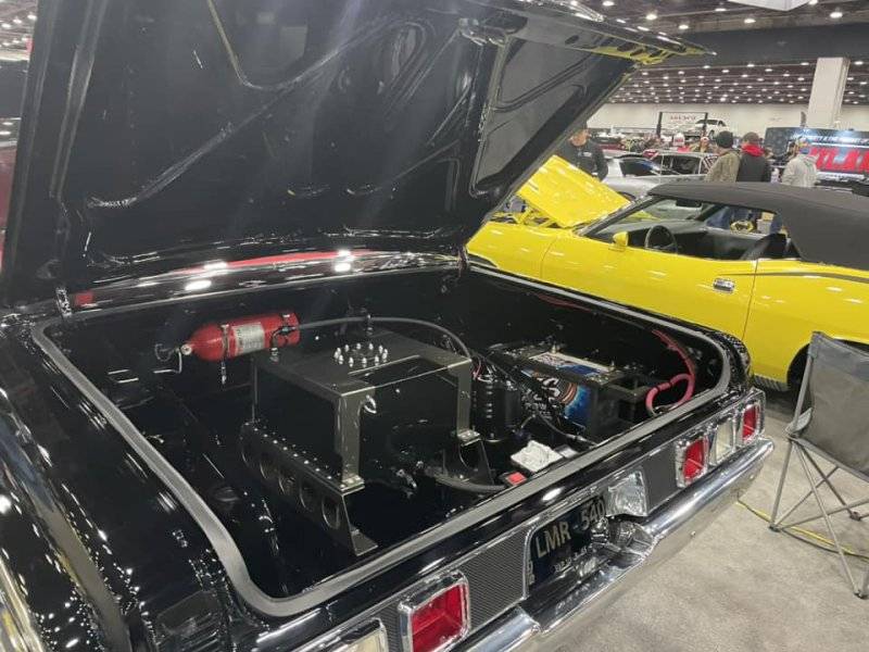

Awesome. And you mentioned you wired the car. Is there a specific kit or brand you like?
I used a ARC switch panel to drive water pump, fans, fuel pump, oil accumulator solenoid. The stock taillight and headlight harness were modified (no firewall plug). The rest is wired with rolls of wire and relays purchased seperately. In addition to the ARC fuse block a secondary new style fuse block was added just below the ashtray. The heater temp control runs the line lock. I like the relays close to what ever is being driven. The fan and water pump relays are on the motor plate. Fuel pump relay is next to the battery. The engine compartment and headlamp wiring is hidden in the right front frame rail.
