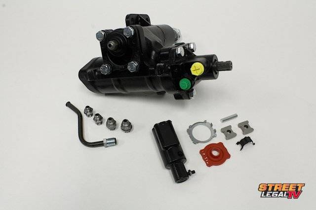

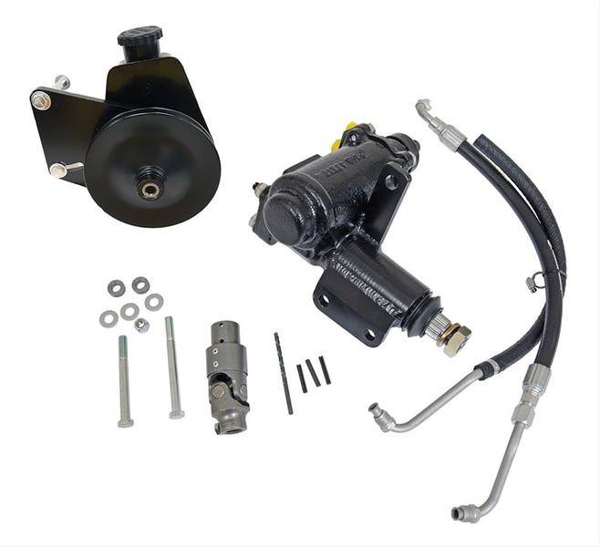

This is the kit that was purchased. We will see how it goes on the install. As a note.. He bought both sizes of pitman arms as well as bought both types of steering adapters. The Ujoint style I believe you have to cut the shaft, the other style says you dont. But I think you have to colapse the column. Which I'd rather not do.
https://www.summitracing.com/parts/brg-999065/overview/year/1969/make/plymouth/model/gtx

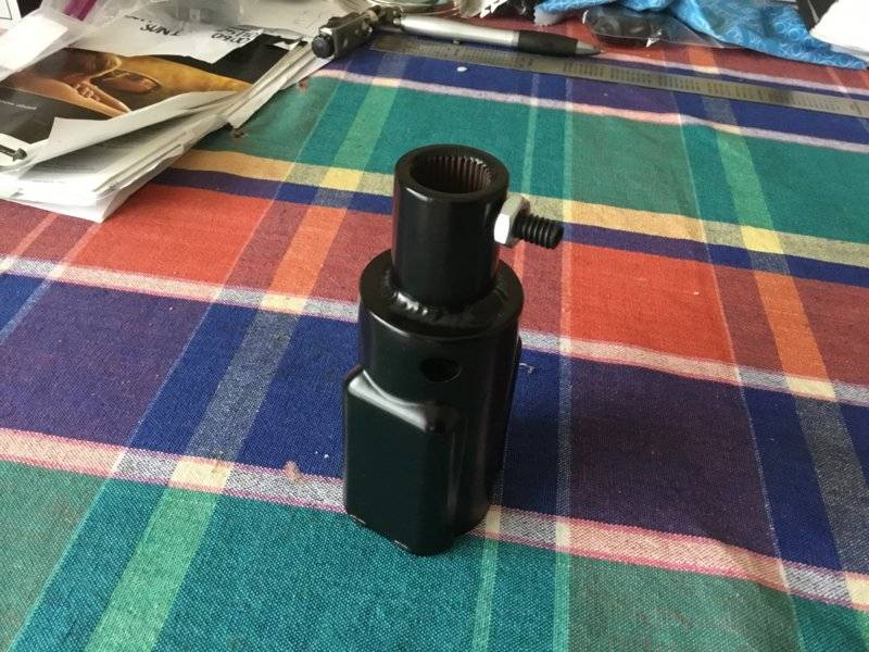

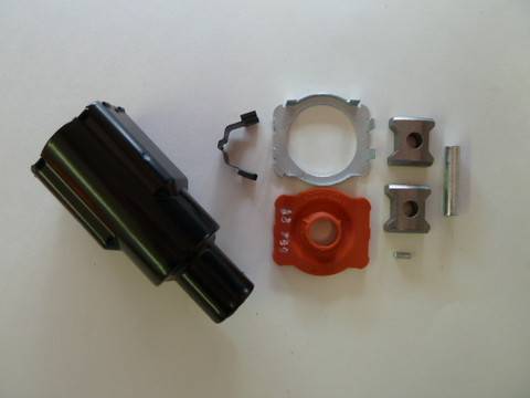

The coupler you see in this picture is the other one he bought. I think it requires colapsing the shaft.

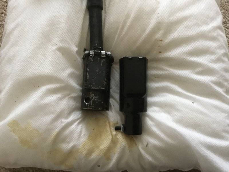

Here is the coupler. and here is where to find it.

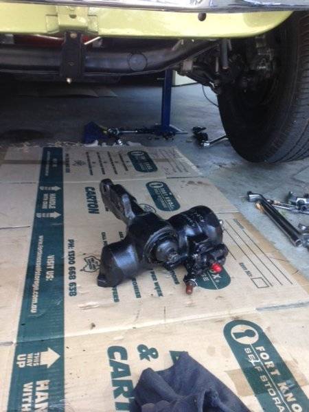

I’ve gone with the Borgeson unit on my GTX mainly because i wanted a modern feel, as I wasn’t happy with the light steering on my rebuilt original box. Also shipping a core overseas wasn’t viable. I went with the Bergman kit with the hose adaptors and universal steering coupler, as i didn’t want to cut my column down in case I want to go original again later. Just removed the box earlier today, and the Borgeson should arrive in a day or two and I’ll probably have it done by next weekend.

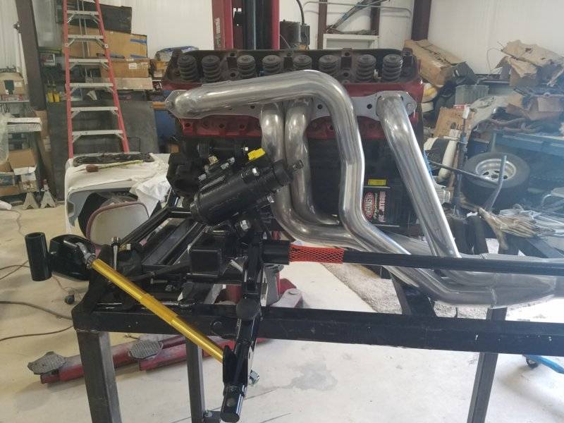

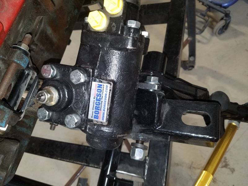

Ok guys finished the borgensen install today. The gear was an easy install. The crank pulley needed to be changed to a 2 groove pully. Most of this install was super easy. The black non cutting coupler says to collapse the steering column. I ended up using the beogensen ujoint style coupler it was just easier to install. The install took a little longer than I expected since i had to sand down the shaft to put in the coupler. The cars owner says it drives great. The steering wheel is dead straight and most of all he said all of the slop was gone. The pitman arm was a quick ratio and it helped the car.
This was a manual steering 1969 440 4-speed GTX

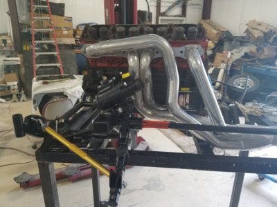

Nice. I stuck with the regular pitman arm as the quick ratio wouldn't clear my Hooker headers. I did switch out the steering wheel to something smaller, lot more fun to drive.
