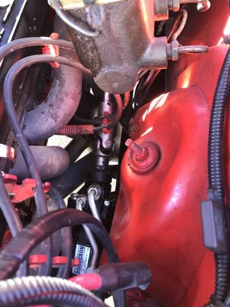

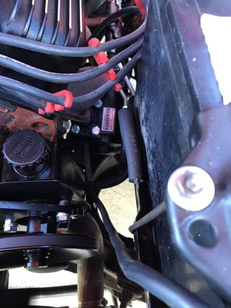

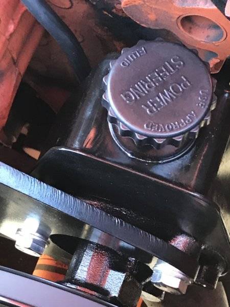

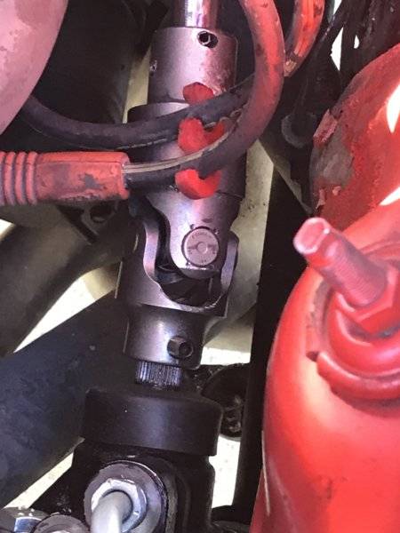

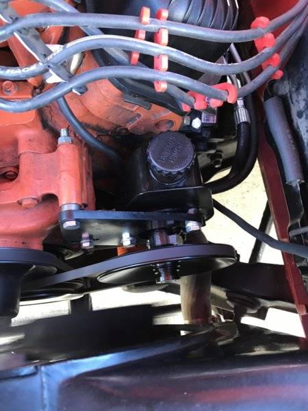

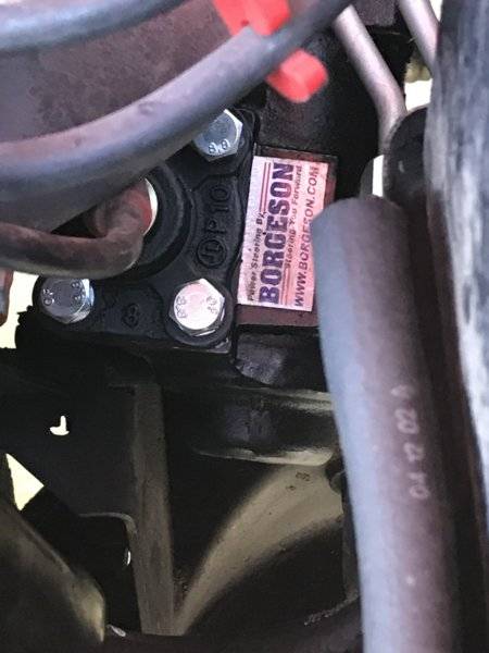

Finally was able to grab some pictures of the install. Not hard at all with one exception that was putting the ujoint style coupler on. I had to sand down the shaft to get it to fit. Here are the pictures of the borgeson kit installed.
Yes it did,also the spacers needed to line up the belts. The first roll pin hole walked on me a bit. But i managed to end up getting it straight. You can see in one picture the roll pin hole is egg shaped. After that the other 2 went well.
I bought mine a few years ago already just putting it on i have a double bracket (both sides of water pump housing) that came with mine but yours is thicker, looks alot cleaner, I ended up making spacers from an alternator kit.
Well going from manual to power is a big difference right off the bat. Its not my car but the owner says it feels like a new car. He compared it to his daily driver 2017 impala steering wise. He says it drives and feels totally different even from his yellow GTX. No slop nothing wierd. Just drives good.
Yes single bracket super thick and all the hardware. The coupler even came with a drillbit for the roll pin. I'd say it all went together well.
