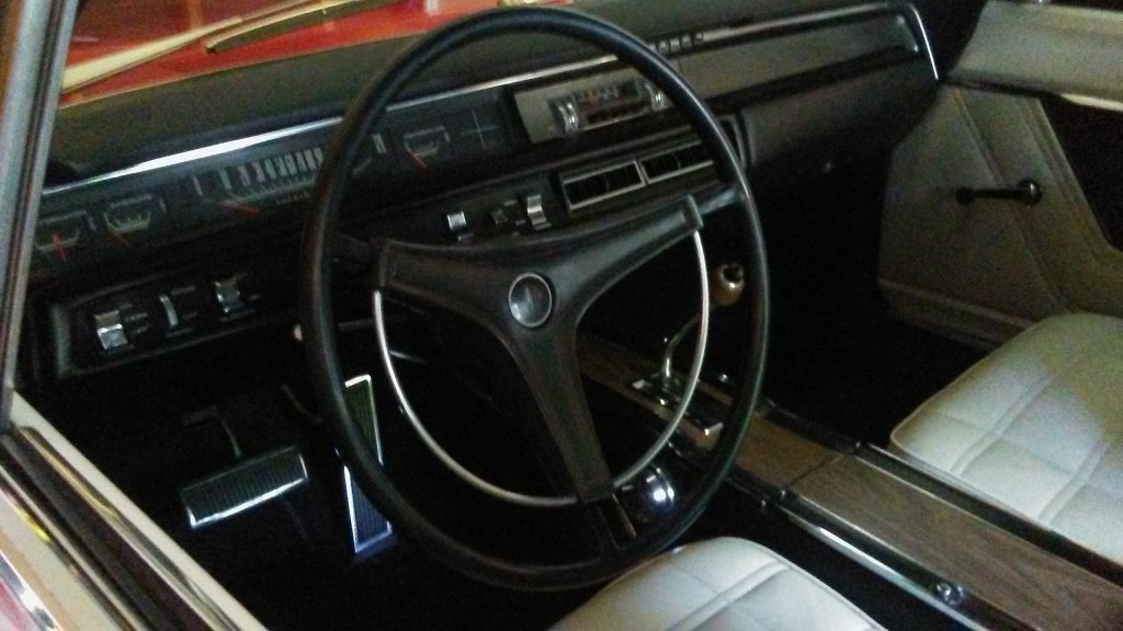

oh its a auto 727 torque flight ,,center counsole

Ok, then let's get basic here. Are the battery terminals at least clean or are they corroded to bejeebus and back? That could cause intermittent starting, so could a bad ground somewhere. Even with a new or borrowed battery,something could jiggle a fraction of an inch to complete or disconnect the circuit.
The NSS or ignition switch should also be tested at least, and in an auto, they are in the transmission and they are in fluid, ergo the fluid comes out if it is removed.
Worst case scenario, Trans linkage is boogered or the ign switch is shot. The linkage adjustment is a P. I. T. A. And the column disassembly is surprisingly easy, I just found that out, actually.
I just fiddled with this very problem and mine came down to a faulty ign switch after I chased the whole circuit stem to Stern AND needlessly replaced otherwise operational partsparts. The parts were cheap but the fact remains, money spent that could have been better spent elsewhere...
