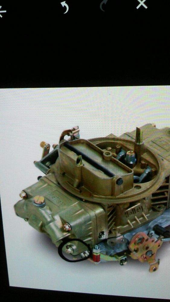

Take a paint can cap to catch the gas and put it under the bolt that holds the fuel bowl on. Engine in car = drivers side for the front bottom right bolt. Passenger side rear bottom right bolt.
Just take them loose. Don't need to take them all the way out.
As u loosen each one fuel will drain out. Catch the fuel in the paint cap. To minimize clean up. Then tighten the bolts up. Adjust your float as needed
You're talking about the idle mixing screws right? I was thinking about doing that but too wasn't sure unscrewing it off. Thanks
No. The fuel bowl screws. Their are 4 on each fuel bowl. At the very ends of the carb.
Loosen one of the lower screws and the fuel will drain out. I had to use the right ones because of clearance under the carb for the cup to catch the fuel.

The bowl screw is circled that I used to drain the bowl bit you have to adjust the floats or it will just fill back up again.
