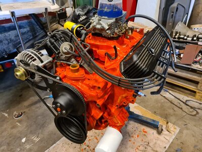

So after break in, which kind oil should i use? The shop manual says 10W-40 but should i use MINERAL or SYNTHETIC?
What type cam you running? Flat tappet requires zinc. I run synthetic blend with a zinc additive. 440'

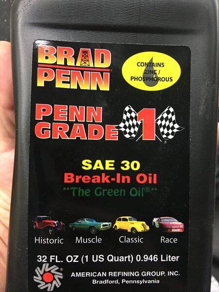

I’m a brad penn fan just buy the best you can get, oil is cheap compared to a failure and the sick feeling you get when you blew a wad of hard earned cash.
Hope you know that Brad Penn is now Penn Grade. Same formula, just different name. Same formula as the Kendall back in the day :D
