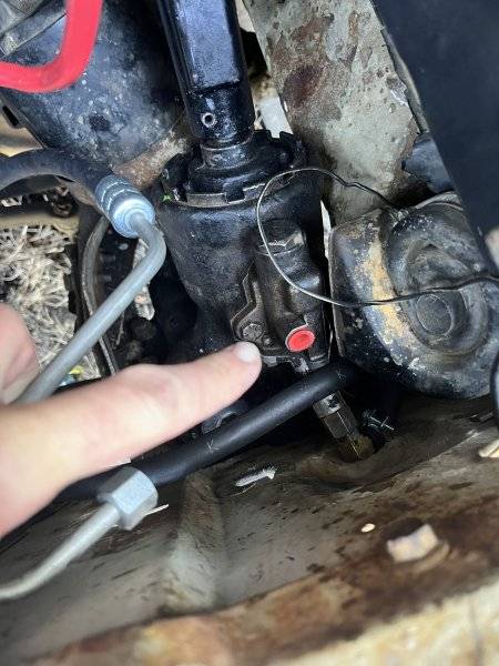

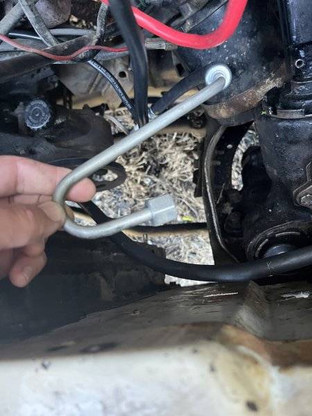

Can we get pics of the end of the pressure hose and this fitting in the gearbox?

There are a few variations.. early cars used a #4 inverted flare up till around 67? next version was a #5 inverted flare till 72 and starting in 73 they went to a O ringed bubble flare...
The steering box has a O ring boss connection that on later boxes still accepts O ring boss fittings but is also machined to accept an O ring bubble flare...
If you look at his line
that is a female inverted flare fitting with a 5/16 steel line... 5/16 = #5 inverted flare....

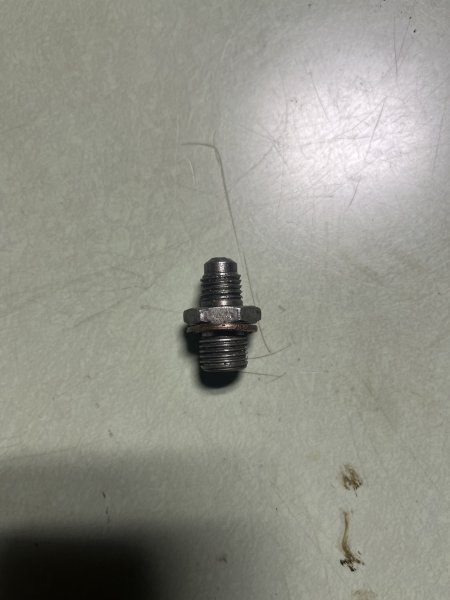

This is what you’re missing. Pretty much every Mopar built from ‘67 through at least ‘81 has one.
A hydraulic shop will have that fitting it’s an ORB to JIC It”s a 1/2-20 for the ORB and you will have to verify the hose to be 1/4 or 5/16 JIC
Thank you! I just don’t know what to call it… want to sell that one in the photo ?
Sure, I’ll sell it. I probably have at least five laying around. Obviously won’t get you going this weekend, though.
