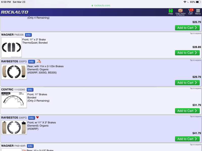

67-71 GTX, RR, RT and Superbee also c-bodies all came with 11x3” fronts. Did you check rock auto thy had them a while back.
Looks like hey are 1965-1972

Rockauto is your friend!

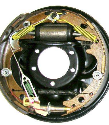

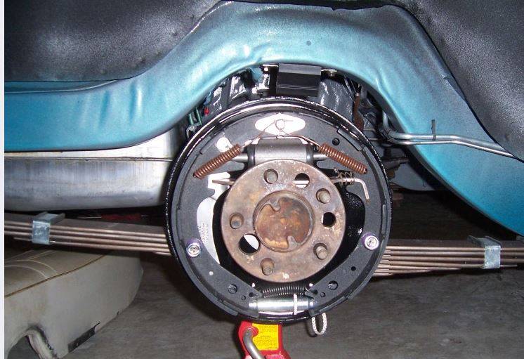

Don't know if those will work the spring that holds the adjusters in place is different, keeps adjuster from turning. Pic 1 self adj. Pic 2 manual adj.
View attachment 738611 View attachment 738612
Mine have a much shorter spring then pic 1 more like pic 2 but with a straight leg on one end.

Photo 1 above is 1970 with self adjuster, B C E bodies there are some changes in the cable, springs, and lever from 1969 self adjusters, C-body only.
Photo 2 is manual adjust.
The star wheel is different on manual adjust with bigger, smoother, fewer, and rounded teeth so the spring coil can sit in there. Using a self adjuster star wheel is going to be wearing on the spring when you rotate the wheel, not the best idea.
