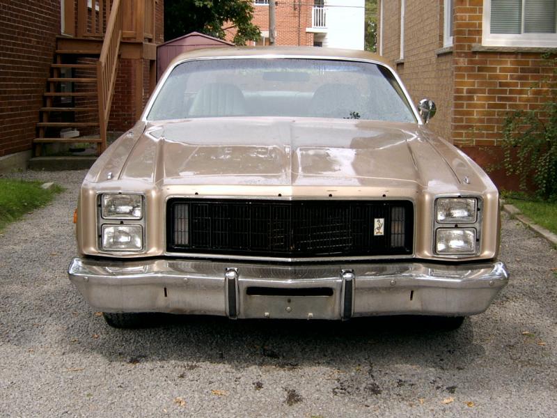

Or more specifically... what all has to swap from my 78 monaco, to go to the 75 single beam headlight?
Headlights, and buckets obviously. I assume the grille? Hopefully not the fenders? Are these parts impossible to find?

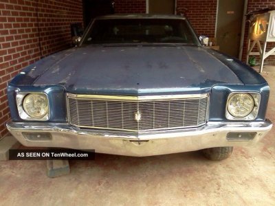

Trying to get away from the 77 monte carlo look...in favor of the 71 monte carlo look lol

The front clip are interchangeable as long as both car (the donor and the receiver) are the same body style
Fury,Monaco,Coronet 2 headlights to quads same with the Cordoba and Charger
The front clip is a one piece fiber glass attached from the inside of the frt fenders and a couple of brackets
if you swap the quad to the 2 headlights you will need to modified the plug/wiring to make sure the low and high beam work properly (pretty easy to do without cutting the plugs I know I did it!)

So i guess i need to post in the WTB section looking for the grille, grille surround, and headlights/buckets from a 75-76 fury or RR? mine is a 1978, looks just like the quad headlights you posted above. so i assume all would changeover ok?
You will need to replace the whole front clip/facia since the design is different from the 2 to the quad

You only change the front clip from quad to 2 round headlight and swap the grill back from the the quad front clip.

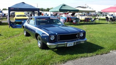

is that RR badge attached to the grille? or is it an add on to the regular fury grille?
All the 75-76 Fury use the same grill they both have 2 holes on the left to fix the little Bird
All the 75-76 Fury use the same grill they both have 2 holes on the left to attach the little Bird
So no actual difference from a rr to a fury grille. Besides the bird of course...which can attach to either?
Yes! Both the same grill 75-76 only in 77-78 they switch for the quad lights and different grill with the "Plymouth" molded at the top the whole width of the grill .

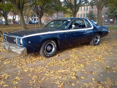

This is my "Bird" after restautration
Mind you a "clone bird" since up here they where few and far between who survive the harsh weather in the Great White North!
Top picture 2011

Carlisle 2015
i don't think there are too many around period! my 78 monaco came from georgia. Cars up here in ohio didn't fare to well, and the nasty winter chemicals they put on the roads now have new cars rusting after their first winter!
VERY NICE BY THE WAY. Same color as mine almost.
