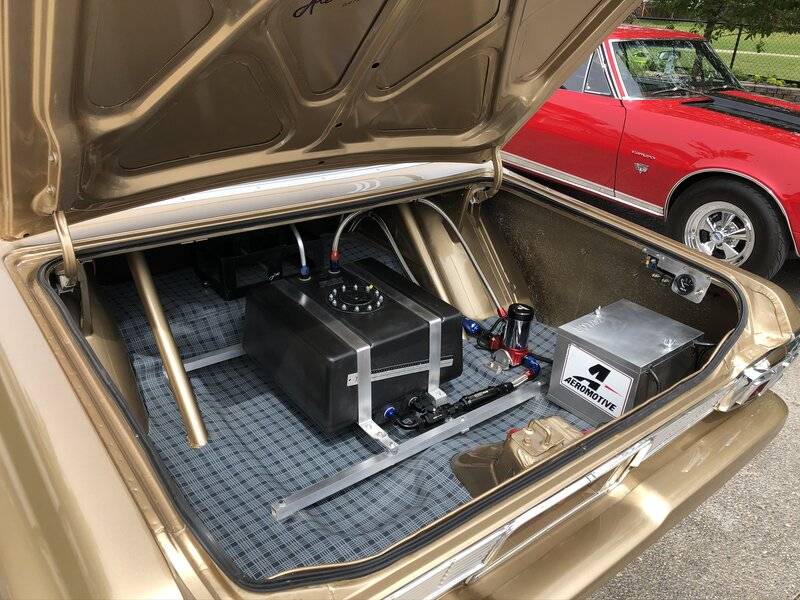

Yeah LW I'm sure it's a 0-90 ohm GM type sender that fuel cells come with. You'll need to change it to run with your dash gauge. I put a 16 gallon cell in my Dart, the 64 has an 8 gallon, foam in both. Switching to a cell is a good choice IMO.
* the paint stick wedged under my bracket is my fuel gauge. I have a hole drilled into it at the 5 gallon spot.
I use a wood lath that shows the level very clearly. It slides down nicely into the foam & is accurate. I also have the correct sender, but I don't have a lot of confidence in the accuracy of the gauge reading.
I have had a jaz plastic fuel cell in my plymouth for at least 20 years, with no sign of problems from the foam. If i had it to do over again, i would buy a bigger one. My plymouth has an eight gallon cell, with room for lots more (gasoline weight at the rear for traction/ballast if neccessary, can run mostly empty if not), my little car has only a five gallon cell, thats all that would fit between the tubs.
