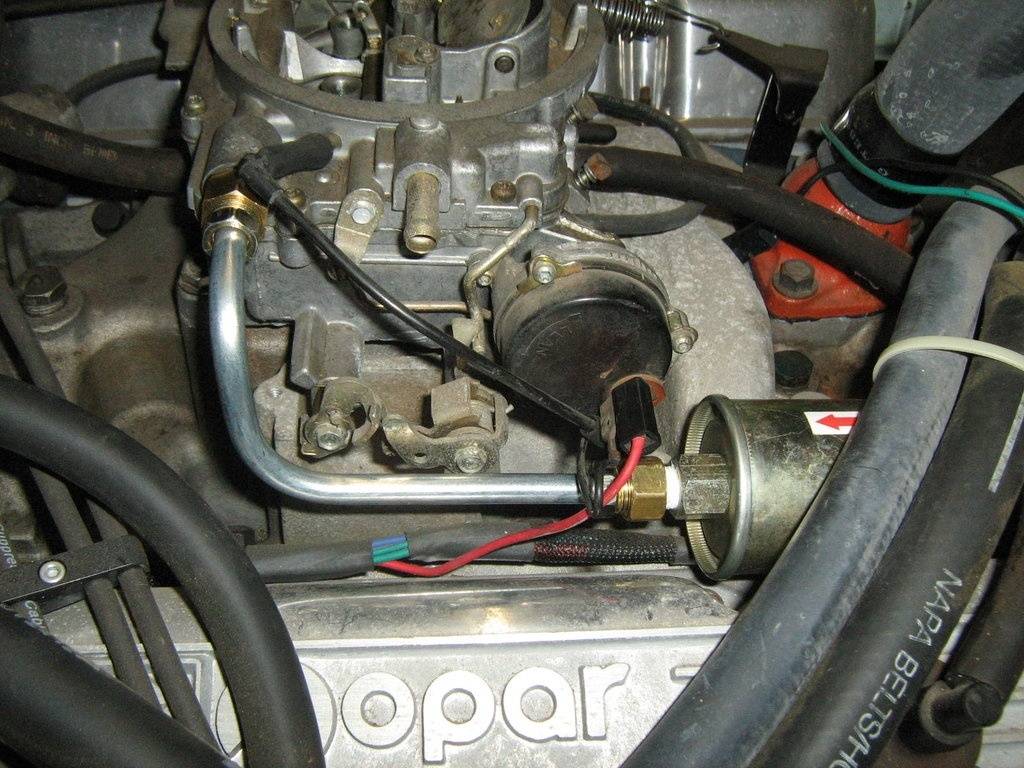

I like the idea of the clear fuel filter, but from what I have seen is engine fires are either gasoline or electrical. The last car I setup used steel lines from pump to carburetor including a metal double flared fuel filter. The filter used adapters for 5/16 inlet to 3/8 outlet, aftermarket carb.

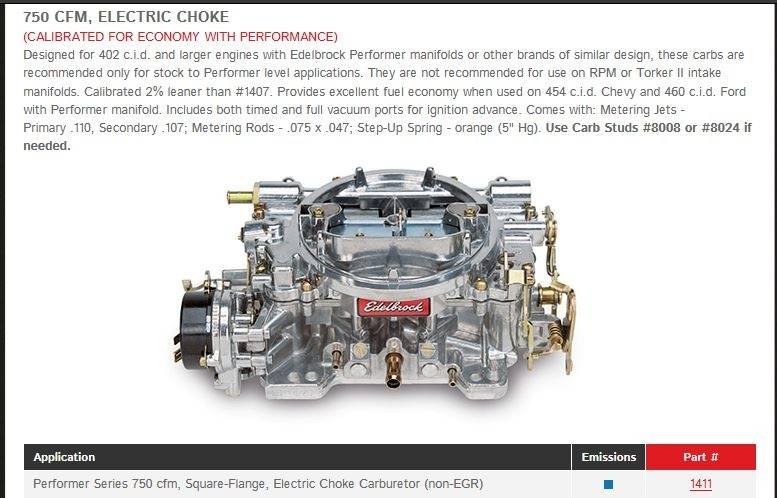

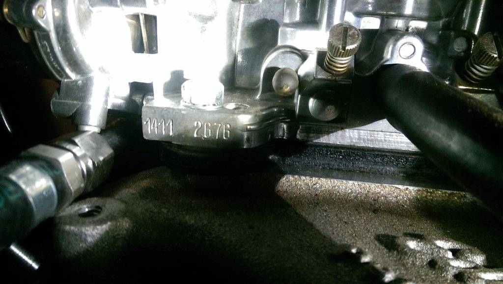

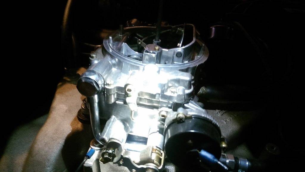

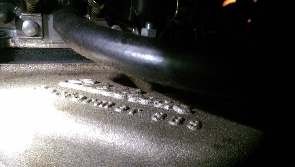

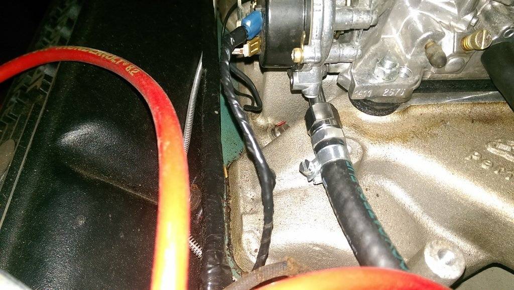

It just occurred to me is it possible that the fuel filter is attached to the line leading into the carb? This is my set up. Based on the #1411, I'm pretture sure this is the stock # for the carb but what does the #2676 mean?
