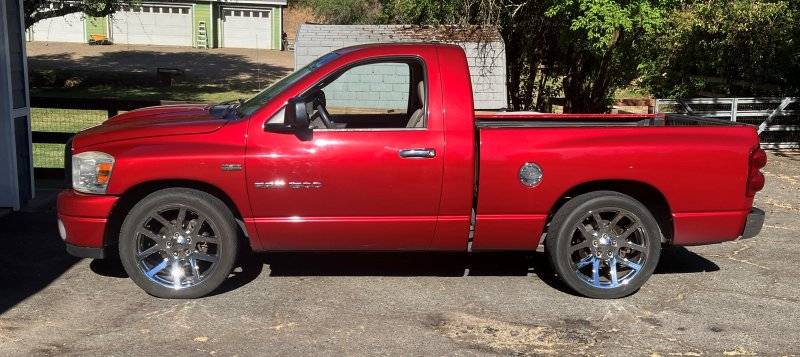

Around the area we are required to run reformulated and corn in our gas. All produced by Concoco Phillips 66. The only difference in BP was the premium was actually theirs. I was a BP dealer for years. Most of the products are the same except addictive packages. Years ago there were differences, I chuckled the other day when I was in Virginia I noticed BP brought the Amoco name back out after killing it.
Back in 1968 when I returned home from the navy, I had a new Charger R/T. It always ran the best on Shell, Deep Rock, Skelly and a couple others that advertised the 103 octane rating. Back then most of the stations got their fuel from their own distributors but those days are long gone as well as the 103 octane. In my neck of the woods now a local tank farm supplies all of the stations except for a couple. I don't know if any are putting any additives in or not. Some claim they are but who knows for sure. I believe it to be an advertising ploy more than anything. I try to run premium non ethanol 91 (the best we have in the area) in everything with a carburetor. I sold my 440 six pack Challenger in 2013 because I got frustrated with having to spend time on line finding stations that had the Premium 93 gas and spending an additional $.50-60 cents per gallon only to find half of the time having to listen to a bunch of pinging. That always told me I more than likely got something less than what I paid for. I couldn't tell but the car could. The 6.1 in my Charger runs well on the dog piss they sell these days so I don't pay much attention. I just stay away from the corn infested garbage.
