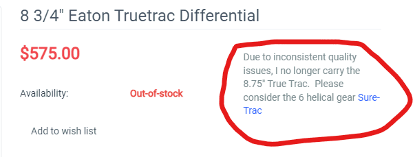

The 8-3/4 version quality is supposedly bad. Dr. Diff won't sell them anymore, see their website.
dam now I'm shattered i got nothing but good reviews from my diff builder he's installed hundreds of them but he didn't specify 8.75

Dr Diff sells a competing unit, 6 rather than 4 worm gears. Maybe check that out, it sure looks unique... I thought it was just a spool from the picture.
