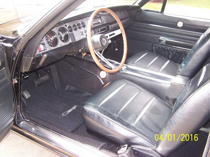

If you don't want to modify the tunnel, you are pretty much stuck with the 904. When I updated my 68 Charger with a 6.1 Hemi, I wanted the extra gears for fuel mileage so modifying the tunnel was the only option I had. Back in 2014, no one was using the NAG 1 because of all the issues with management which have now been dealt with. I used the 545RFE (truck transmission) because of the two extra gears and it doesn't need any special regulation. I had to raise the tunnel 2.5" and widen it a little to make things fit but I am happy with the results. My console is higher than normal but no one notices the difference. It don't have the best gear ratios but it provides me the fuel mileage (+20) I wanted and the only time down the track it ran a 12.88 @ 103 mph. With the 3.23 sure grip, the RPM's are at 1700 at 70 mph.
I didn't like the looks of that ugly fly by wire gas pedal so I used the factory pedal and a truck bell crank to run the throttle. With the hood closed, the car looks completely stock. You didn't say what your final expectations are so no leadership here. Just some reasoning behind mine.
