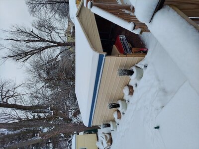

I had a Carolina Carport delivered and built 5 years ago. 20x21 with 2 closed sides rated to 140 mph hurricane winds per New Jersey code. It was $2400 installed in 1 morning. Those guys are quick! Yes, it snowed this morning.
yep.
Mine went up in less than 1 day as well.
