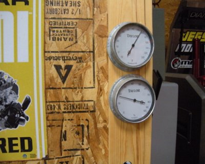

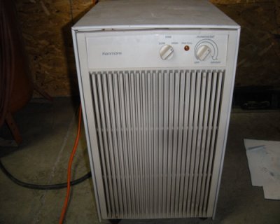

Here's something else you might want to consider; in our part of the country humidity is equally an issue along with temperature. In my shop, 30X60, I run a free standing small dehumidifier that has a drain hose plumbed through the wall. During the summer, I let it run and even though the shop is almost 80 degrees the humidity is about 15% and its very comfortable. even when it's 95 and 80% humidity outside (like it was yesterday). the key is keeping the doors shut as much as possible.

I run a dehumidifier all year long but in the summer it does generate quite a bit of heat, but in the winter, it does help with keeping the garage warm. No matter, it's a big plus.
