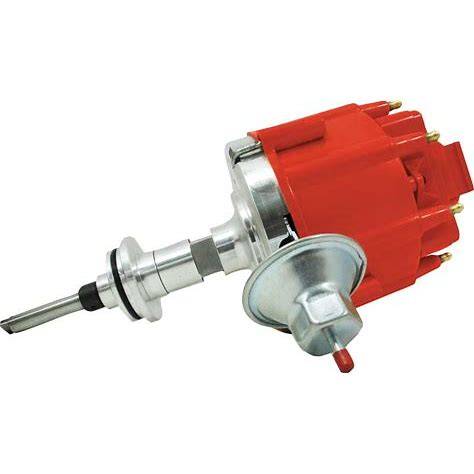

Classic Industries has one available:
MN2517
$ 74.99

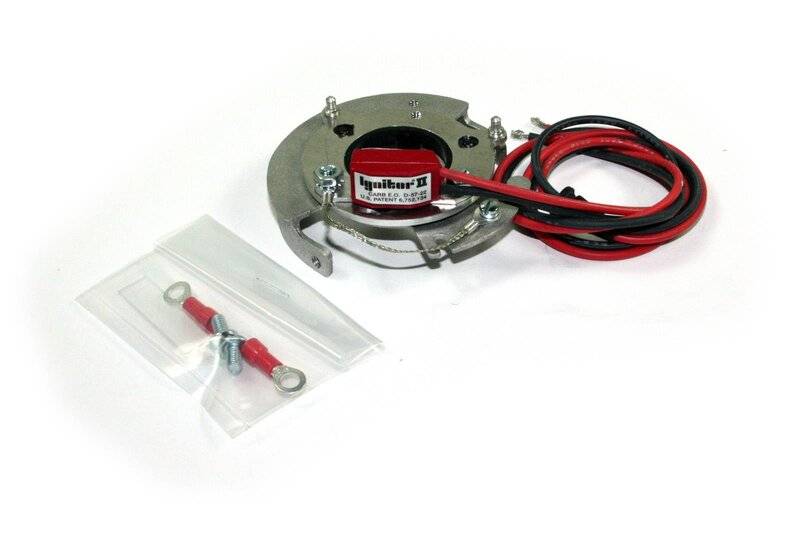

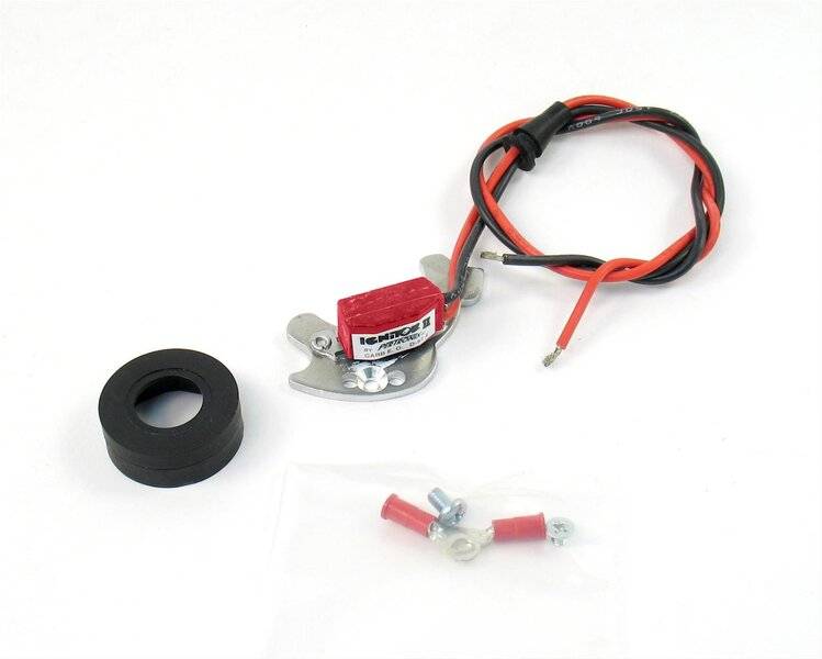

I used a Pertronix II kit inside my single point distributor on my 62. Might be worth a look.
I installed a Pertronix 1 kit in the Poly stock distributor and in many of my other cars. Never a problem.
If you don't mind the look of the big cap, what the heck, go for it !
I agree with the pertronix, and disagree with the gross chevy ice cream pail.
Looks like the Petronix 1 kit is now being replaced with the Petronix II
91382. (Mopar)
91385 (Mopar)
ski, FYI, read the directions. I believe the Pertronix 2 you have to by pass the ballast.
