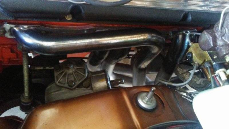

I imagine you used this piece pictured below as a torque strap for your car. Do you happen to have any pictures of it installed?
OK. Now back to work!!!
Hawk, I found one picture on my phone. The bolt went through the upper motor mount boss, and I drilled a hole in the middle of the lip of the K frame. The rubber bushings went on either side of the K frame hole to provide some cushioning. Remember this was on an A body cuda, so the K frame would be different.
Awesome - thank you!!!
The picture is great as it helps me to narrow down the possible installment methods, and thanks for the caution about the possible differences in the K member. I'll see what I can mock up. I'm not 100% sure I need it as I have locking type motor mounts, but it would be nice to have the extra insurance.

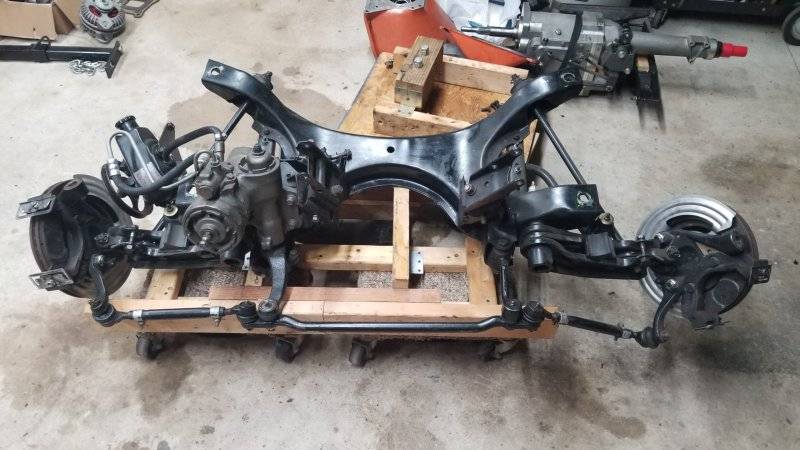

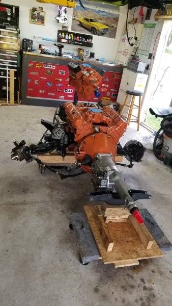

Here are a few shots with the driveline out of the car. I keep telling myself I'm going to make a nice setup to hold the K member and transmission assembly, but I never seem to get it done and keep using my old method. But, it works well so I guess maybe I shouldn't worry about making anything.
So I am happy I had success getting the engine out so easily today, especially since I was working alone.

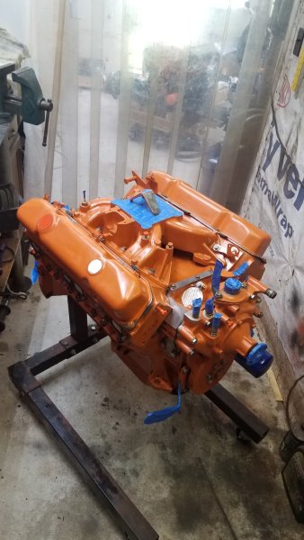

I spent today working on the new 500 stroker engine getting it cleaned up, as well as moving needed parts from the old 383 to the 500. My stock valve covers took me the longest as they first had to be cleaned, but then also modified so the baffles are not hit by my valvetrain (the roller rockers need additional clearance).
And then clean, again and again.
Finally, I had everything masked off and ready to go.
By the way, I cut refrigerator magnets into circles to cover needed holes. I used three for the valve covers and one for the distributor hole. Much easier than masking and a cinch to put on and take off!
I then spray bombed the entire engine with Hemi Orange VHT Hi Temp engine enamel.
This is far from a perfect paint job. Some of the chips in the old paint show, and my old valve covers (that I salvaged and were very rusty) show a fair amount of "texture" where they were pitted. But it is a serviceable paint job and will hopefully look decent enough when you pop the hood. Plus, maybe that will further make it look like just a stock engine!
