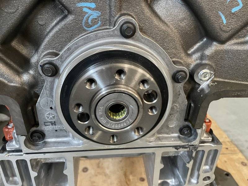

Here's the rear main seal on my 6.4 crate Hemi. What an improvement!
I always had good luck using the Billit rear main that Mancini sells
Sure, put pressure on me... :p :rolleyes:
(That's what I have on mine.) So now the pressure is on me for how I installed it! Hopefully I'll have the answer within a week. I reused the seal since it only had maybe 500 miles on it, but the side seals had taken some abuse when it cam apart. However, I flipped them over to have the beat up parts near the oil pan and used a little RTV to fill in that area.

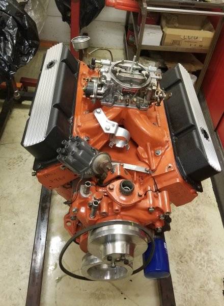

Of course, the first thing was to get it on the run stand, so off the engine stand it came.
Next I needed a flywheel. I borrowed my buddy's @67BluonBlak 67 GTX 11" flywheel. It doesn't need to do anything but spin, so I left the protective tape on the machined surface.
I then used his bellhousing too (I think the colors work together?!?)
Then I was able to mount the assembly to the engine stand and begin adding all needed parts.

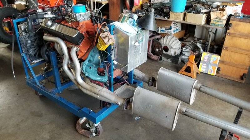

I pulled my headers from my 70 on Monday, and brought them up to my father-in-law's shop. Of course, they bolted right up and fit perfectly - they are TTI headers after all!
I then ran the engine. I have a couple of short video's but I don't feel like posting it on YouTube. Imaging the above picture going vroom vroom! By the way, note my custom electronic ignition wiring on top of the gas tank!
Overall, here is the report card from running the engine about 40 minutes total:
I detected no oil leaks, the engine runs strong and idles nicely. Basically, it behaves just like it should!. It also twists the whole run stand with torque when you rev the engine - that's a good sign.

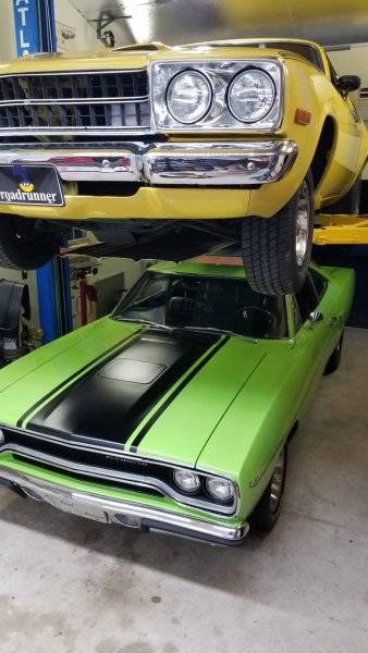

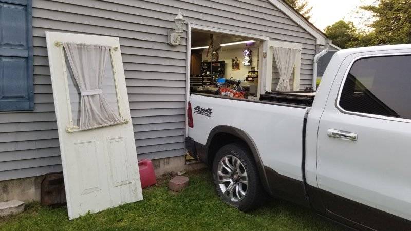

Now getting it into my garage proved to be a challenge. I have special beams that can handle engines, but my 70 was now "dead on the lift", so I couldn't back into my garage. I had to bring the engine in through my side doors. There wasn't enough clearance for the tailgate so I even had to remove a door!
Here is a view from inside

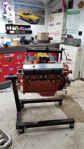

But, it all worked out and now the engine is on my engine stand in my garage. Now I will glean it up, paint it, and then replace the 383 with this one.

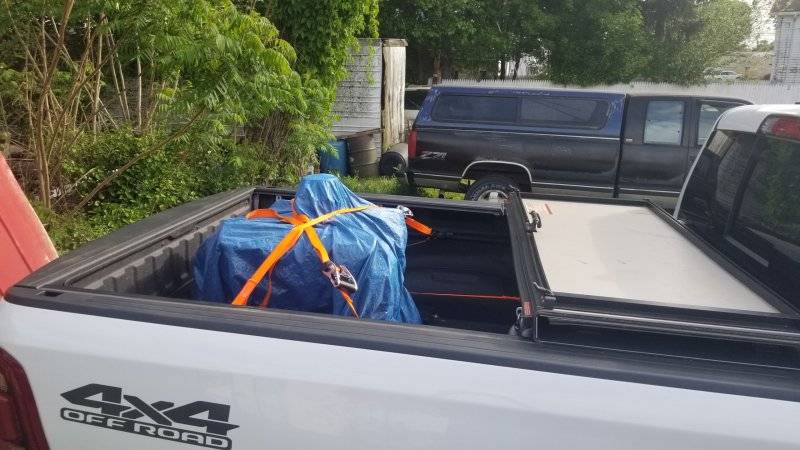

Next I broke it down and put the engine in my truck for the ride home.

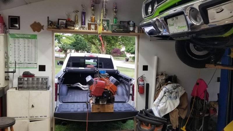

My neighbor across the street was around to help me, but there was no way I wanted to try and unload a fully built engine by hand - with my luck, I would have dumped it on the floor!
I have lifted fully built 727s in and out of my 73 Road Runner trunk a few times, but they are light comparatively. Nowadays, I try to stick with a pickup truck, chains and hoists!
